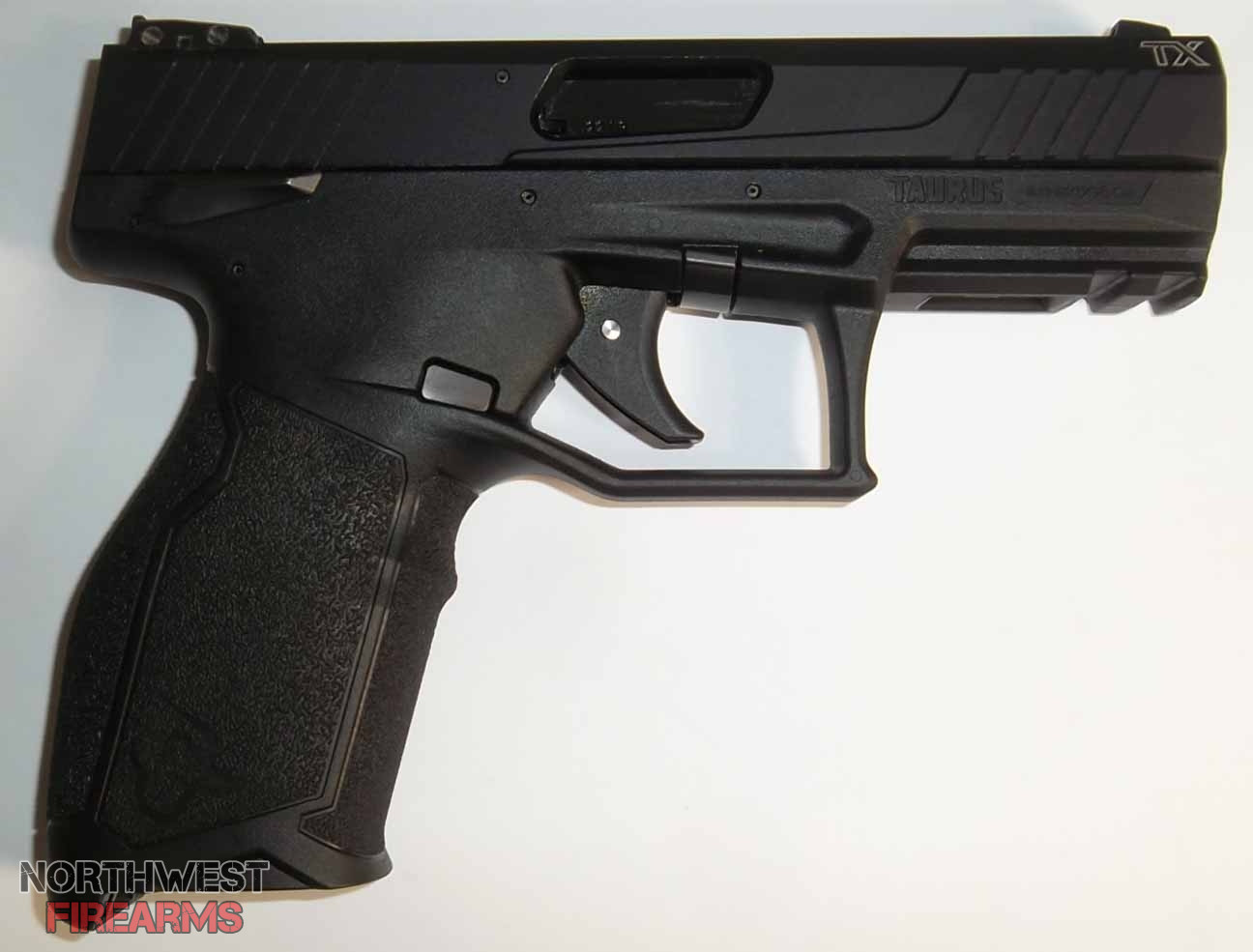

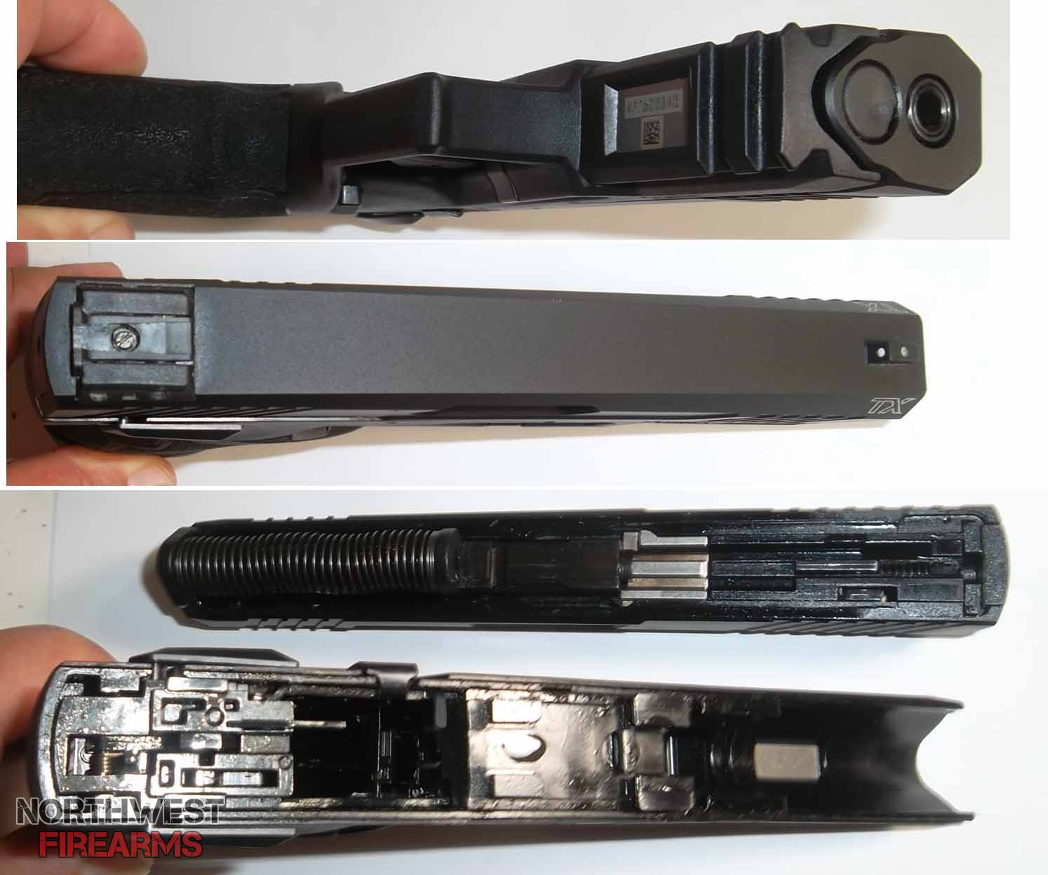

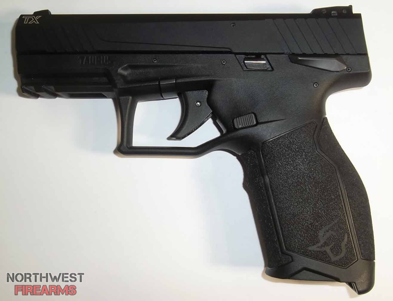

Surprisingly when start doing the dry lube, all of my firearm was able to maintain its fresh looks like this TX-22 that I fired approximately 7,500 rounds, beside its flawless in and out, I have never changed 1 part on this firearm yet. The slides are firm, no slacks or rattling at all. Hopefully I get more of the same on the Ruger 10/22. But so far so good and it performs very well.
