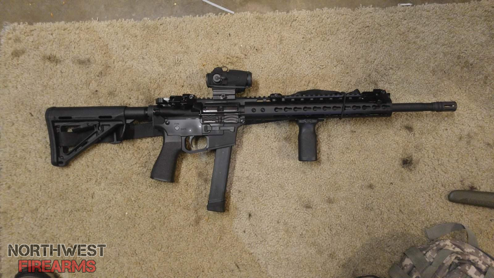

Hey all
I just put together a 9mm AR carbine and am wondering what the ideal zero would be.
16" bbl, using an optic with a 4 moa dot.
Ive read 25m is ideal... anyone have actual experience?
