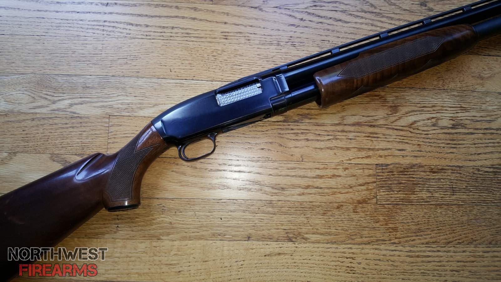

OK..now you have me jazzed up on M12's again. Here is some model 12 eye candy. This was a high school graduation gift from my father. As it came from the factory ... sometimes called a "Y" model.
