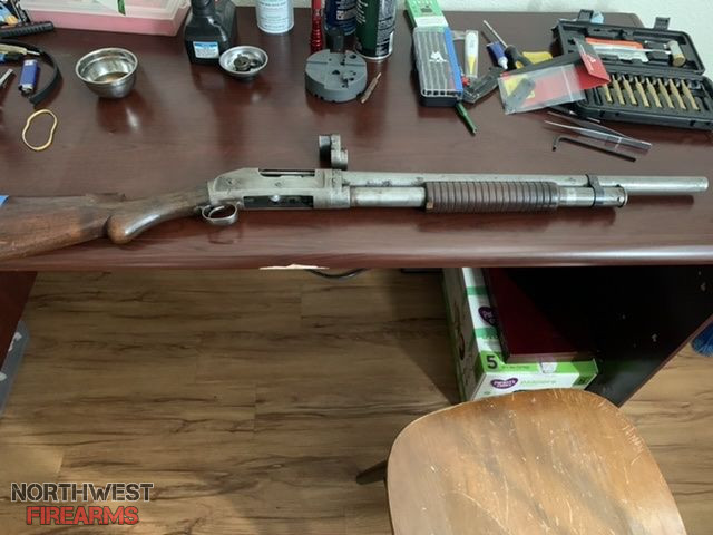

I used a Numrich shield for this build and I think it's a nice piece. It looks great and feels solid. Here's a closer picture of the part.
I have had so much fun reviving these old Winny's, especially the take down's as they were never made as "Trench" guns, which actually makes them even more handy! I just found a origional clunker 97 full length that is all kinds of messed up, the barrel is toast, and the trigger shoe is actually broken, and the action will not cycle! I couldn't see it tossed in the scrap pile for recycling, so home it came! Need to find a barrel for it, and figure out what other parts it's going to need, and then Take it to @Velzey to work his magic!
Same here. Barrel that came on the gun was from a model 12 and wasn't even torqued onto the extension all the way. Found a 97 barrel w/ extension and it actually fits well, but definitely needs to be reamed and polished. I may end up ordering a reproduction barrel from Numrich this week
