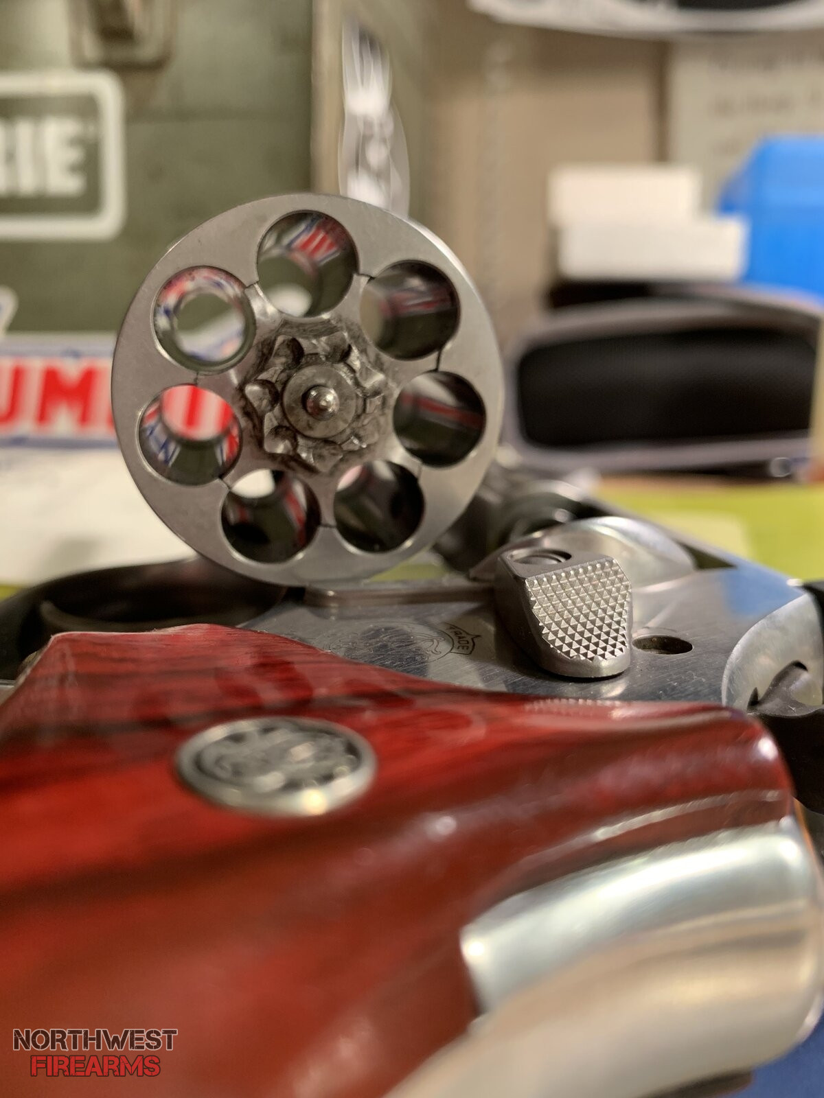

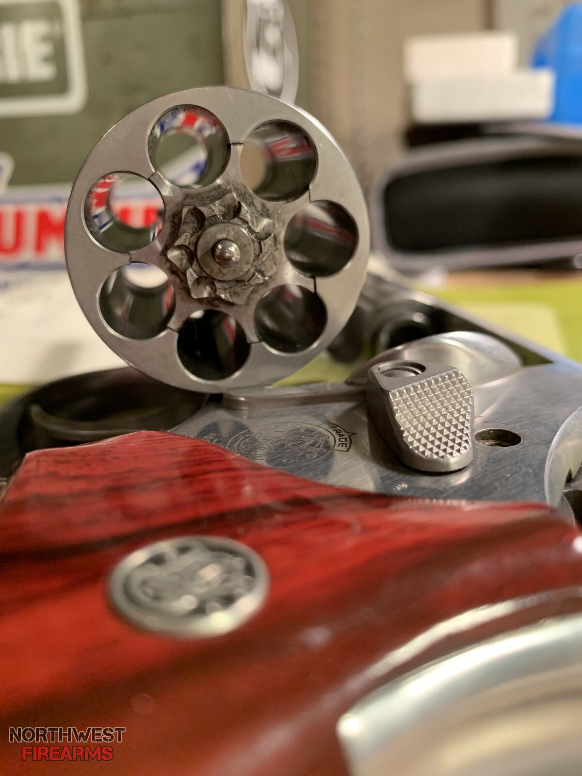

The story behind my question was about a 686+ I bought "as new". It was in the same area as new firearms, and it looked really nice. I read the as new on the tag and figured it was an older unfired gun. When I received it all to take home I just grabbed the case and left the store. Out in my vehicle I opened it up and the case was old and dirty, missing just about everything a new firearm would have in the case as well. I looked the gun over better and only then noticed the scratches, the wear, and the obvious signs it had been shot a lot.
I was not too happy but I decided it was on me for missing the little details. I took it to the range and that is where I found out it was worn out, out of time, at the ejector star. I took the gun back the next day and pitched a little fit over the As New designation and showed them the wear and out of time issue. The shop did not focus on the As New part at this time but offered to send it back to S+W for repairs. When the gun came back it had a new ejector star and was still a tad late on timing with enough drag. The salesman took me to the new guns and showed me a new one that was timed the same. That is when the As New thing came up again. Because the gun looked as new under their lights it was sold that way. I just happened to be the dummy that did not do my due diligence when buying...I got a whole lot better and checking out firearms after that.

Reputable is the key word. I have never stepped foot in that gun shop again. I also sold that revolver to another shop with full disclosure and turned over all my paperwork to show them the paper trail. I only lost $50 on the whole deal and was happy to be rid of the gun. The only reason I sold it after it got fixed was the poor design of the gun. The ejector star legs were not designed well enough for the heavy 7 shot cylinder and the issue was going to come back as they only swapped out the star...the cylinder had wear as well but was not replaced because it was "good enough" with just the new star.
I really look at the ejector stars closely for how they are designed because they need driving legs and stopping legs suitable for the weight of the cylinder. Since most manufactures stopped pinning those stars the legs become very important.
This is the gun......look how worn those legs are...one photo shows cylinder held to the right and one to the left.. a 16th inch difference.
