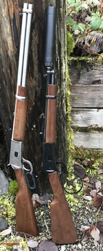

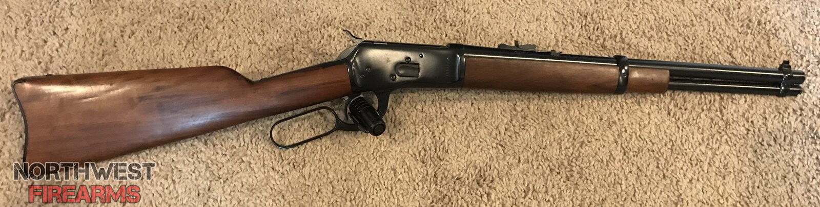

Smoothing up a Rossi 92 action is pretty simple. Look on the internet for disassembly instructions. There are also how-to's for smoothing the action. Here is one, but it is not the one I followed: https://www.gun-tests.com/rifles/working-rossis-model-92-lever-action-carbines/ It seems to be very close to the procedure I used. Basically, you are speeding up the wear-in of the moving parts, and nothing needs to be replaced or seriously modified, except the following two items:
First, most people look askance at the plastic magazine follower. Actually, it works quite well, but it is possible to distort it by leaving the magazine full for long periods with high temperatures.
Second, there are many reports of excessive force ejecting brass. My experience is with a .357 Mag. model, and it threw the empties into Low Earth Orbit! I wound springs from several diameters of music wire, and the first (and lightest) I tried reliably tossed the empties just over the right side of the receiver and dropped them by my right toe. This makes collecting up brass for reloading very easy. I believe that several vendors online sell lighter ejector springs.
My rifle is a 20" carbine and is very fun. Light, shoots well, handles nicely, and is long enough to make muzzle discipline pretty easy. It balances nicely with this length barrel.
I use two loads, a full-power (but not maximum) load with a 125 gr. RNFP jacketed bullet at about 2200 FPM, and what I call "putt-putt" loads with a 158 gr. lead or coated RNFP bullet at about 1050 FPM, which is subsonic. The light loads shoot and feel like Standard Velocity .22LR, and are really fun for plinking. To compensate for the point of impact, I have a tang sight that I use for the hot loads, and a folding open sight that I use for the subsonic loads, since I shoot them at shorter ranges.
