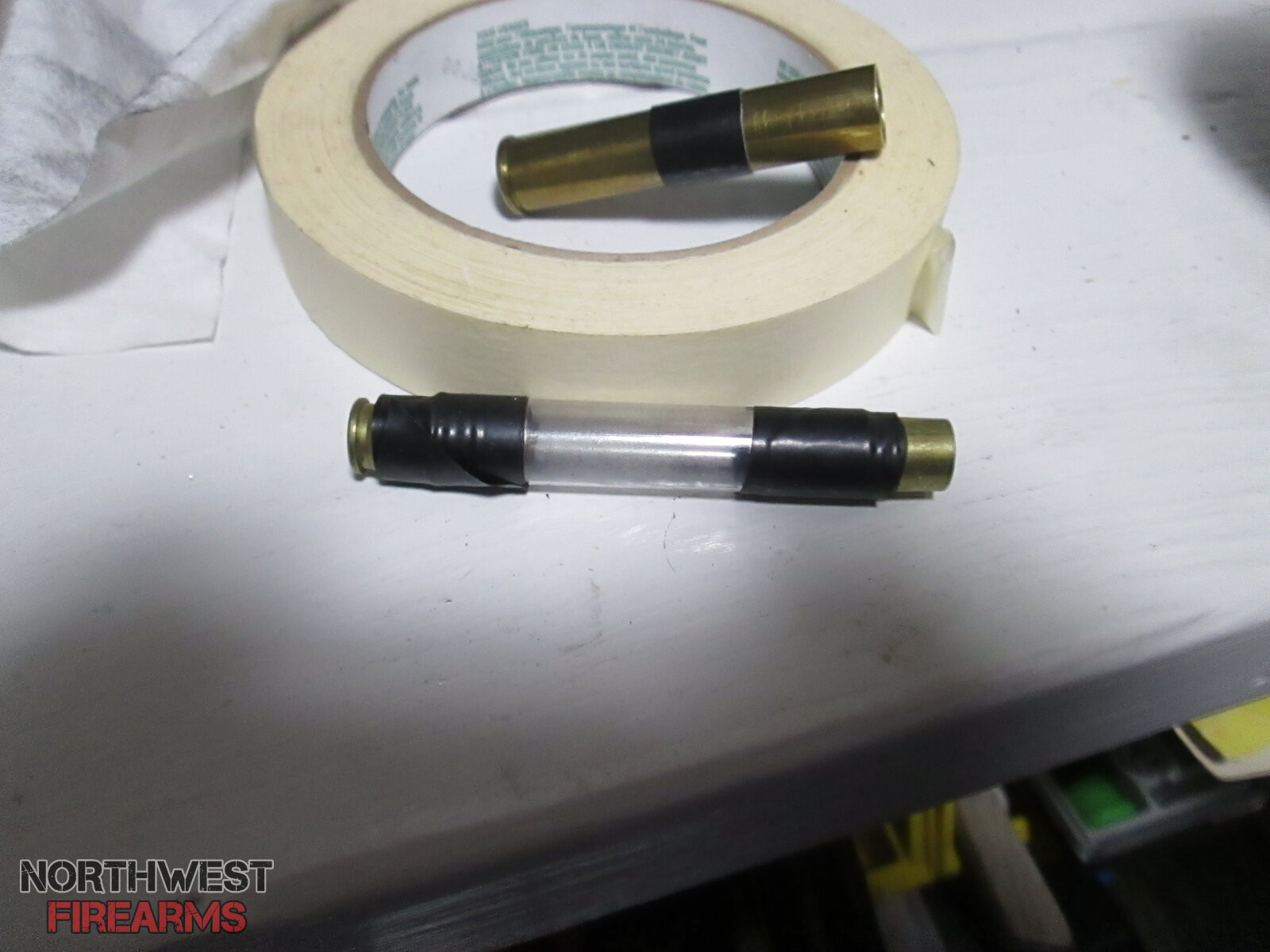

Konrad has a interesting visual guage for checking powder level in the case, Konrad's reloading procedure
There is also some things to learn from him on simplification of loading match rounds. He is a very good service rifle shooter and does not spend much effort in his reloading of match ammo.
