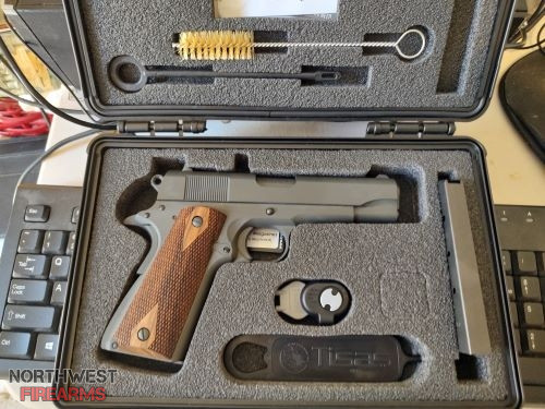

I purchase the 1911 "Tank Commander" (4.25" barrel).
First impression is that the recoil spring is really "heavy"; racking the slide is upper body exercise!
Also, as mentioned earlier, the provided mags seem cheap; they don't hold the slide back on empty and the follower sticks out the front when empty.
Otherwise I'm extremely happy with the purchase.

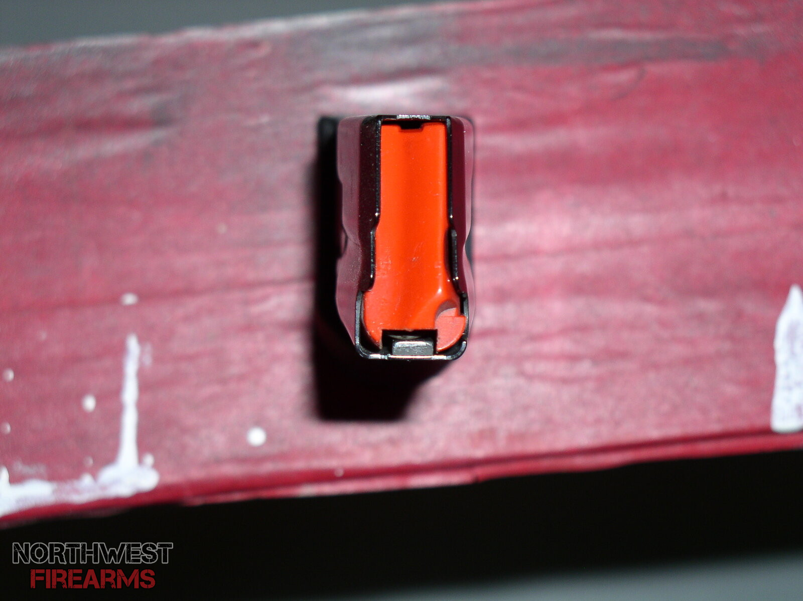

I had the same problem with one of the Mec-Gar mags that came with my EAA Steel Compact. I purchased two extra Mec-Gar mags that were marked EAA on the packaging and they ran flawlessly. I couldn't get a round to chamber with the mag that came with the gun. I sent it back and the one they sent as a replacement worked great. The magazines have a thick rib that runs down the front inside of the mag - never seen one like it. That was causing the problem as it appeared to be off center, out of alignment. Maybe US vs. Italian made?
Mec-Gar makes magazines for many gun makers and I have never had a problem with them or extra mags. Mec - Gar has a great reputation.
...The magazines have a thick rib that runs down the front inside of the mag - never seen one like it. That was causing the problem as it appeared to be off center, out of alignment. Maybe US vs. Italian made?
Thick rib that runs down the side???
That sounds like a 9mm 1911 magazine.
