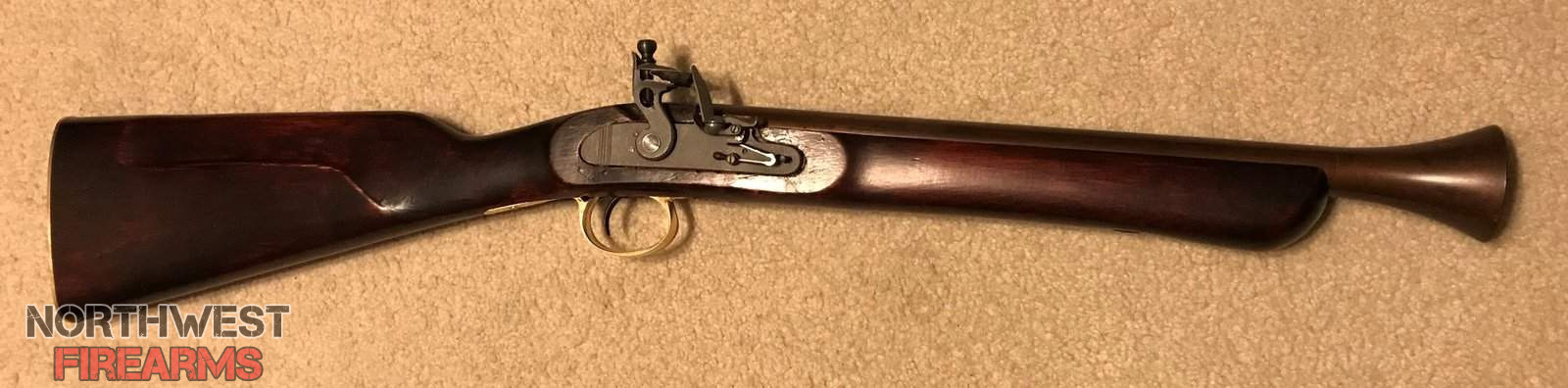

BUT... what is wrong with the picture above? A percussion lock? You got it.
This gun needs a Flint Lock - period. Totally anachronistic with a percussion lock.
I went and bought an RPL-02-F Flintlock (excellent quality) and with minor fitting in the lock well and trigger linkage, it worked fine. And l am here to tell you that it looks MUCH more real!
I then stained the stock antique mahogany and buffed it out to make it look like it has about a 200 year old patina, And you'll also note that I browned the barrel.
What do I think? A heck of an easy kit built from quality parts. Just loose the Percussion Lock and it makes an excellent addition to you collection!
