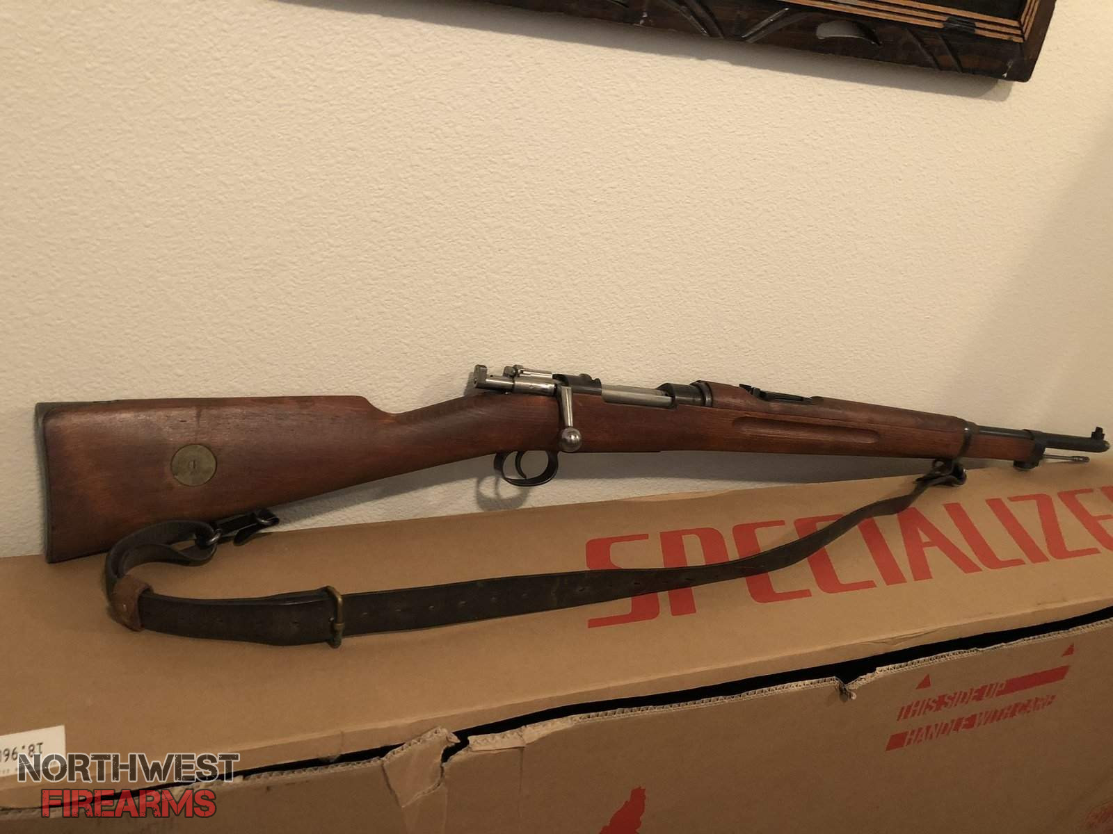

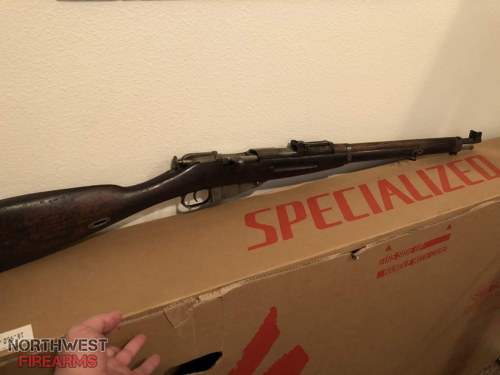

Hey Guys, hoping you can give me a bit more info than the basics on these two rifles. One is a 1943 stamped Husqvarna and the other is 1934 Mosin stamped SKY.
I'm lookin for any details, value estimates, history lessons, etc...

Well, the Swede is a Husqvarna produced model 38. It is shorter than the M96 rifle, longer than the M94 Carbine. Likely not a converted M96 (also known as a M96/38), as it has the turned down bolt. It is a very nice rifle in a great shooting caliber. Value is all over the boards on Swede Mausers. The M96 seems to be the most common and least expensive variant, the M94 the least common and most expensive variant. The M38 sits right between the two.
I have seen them sell for as little as $300 and as much as $700. If I were selling that one, I would probably start by asking around $450-$500.
The Mosin Nagant is a Finnish rework. I want to say the SKY marking is from the Sako factory, but I could easily be wrong, as the Mosin variants are not in my wheel house. I would say a low end of $400 on that one, if not more. Someone else can step in with better info and correct me if necessary.
Both are nice higher end surplus rifles. The 6.5 Swede looks to be in original condition, which is a good thing and your Mosin is a Finish (Finland) M28. Similar to the M39 (has a pistol grip on it's stock) but a little difference such as a straight comb instead of the pistol grip. Also the letter S inside the gear means that it was produced by the Sako factory.

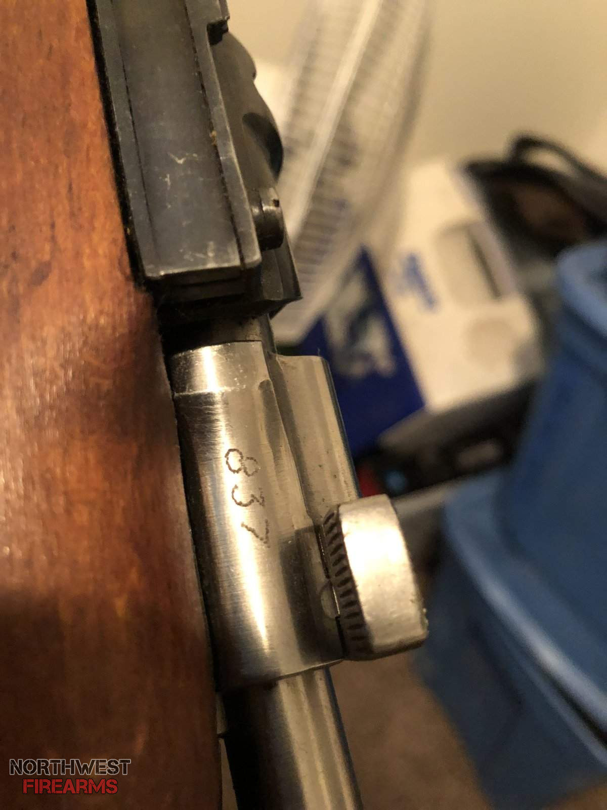

The Swede is probably not all original. The bolt shroud looks to have an electro-penciled force matched bolt shroud. Pretty common. Might drop the value down a bit, but still a sweet shooter.

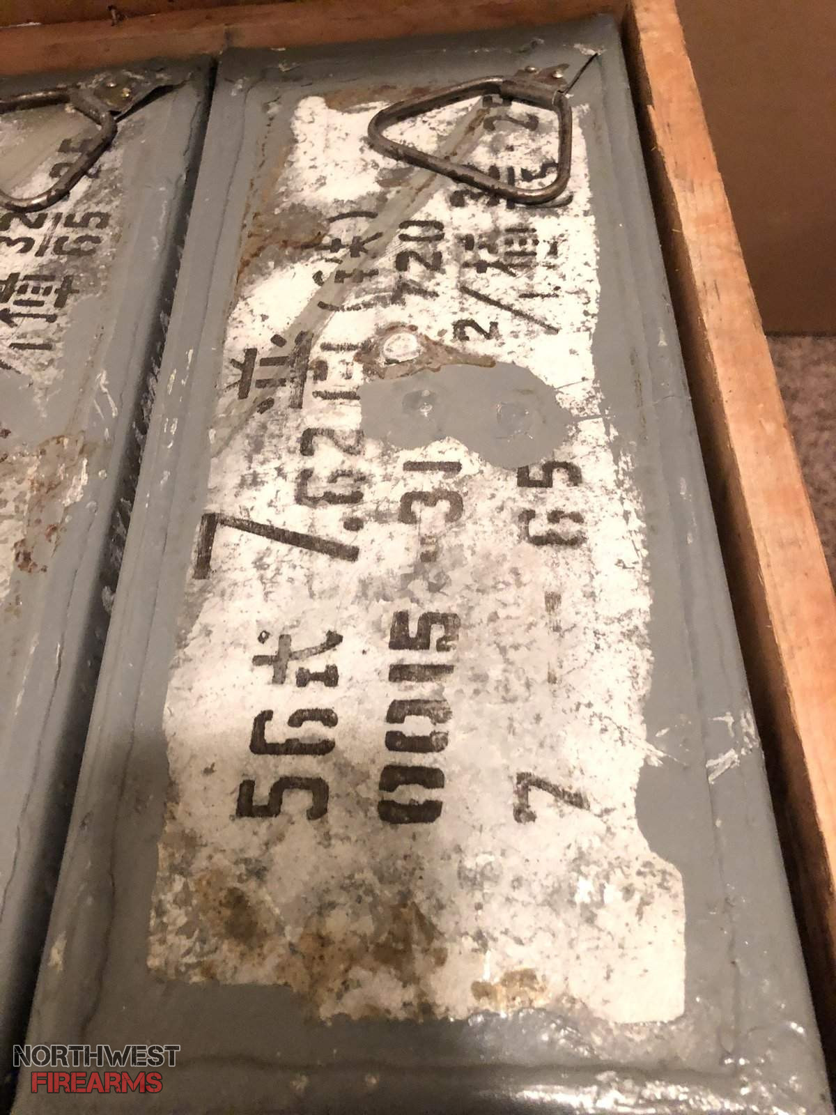

I can't read Chinese and I haven't had the pleasure of opening a Chinese tin of ammo. So anyway, looking at your wooden crate and that the number printed on the side "1440" seems odd for 7.62x54r. If I were to assume 1440 was the number of rounds....then, I'd suspect 7.62x39 ammo.
The typical newer Russian wooden crate contains two cans of 7.62x54r. So, 880 is usually printed on the side of the crate.
So, maybe it's the wrong wooden crate or the wrong tins within the crate?
Have you opened one of the tin cans? Does the actual can contain 7.62x54r or 7.62x39 ammo? And, if you do happen to open one, can I get the round count?

Hi Mark, I haven't opened either of these tins, but I was given another tin that had been opened and it contains packages of paper-wrapped loose rounds. One of the rounds pictured above (not the 6.5) came from that opened tin... the tins are marked "56chinesecharacter7.62"... I'm hesitant to open one for fear of losing its sell/trade value...

I'm with you on that point. No need to open a tin if the writings appear similar. I'd assume.....it would probably be same kind of ammo inside 7.62x54r or 7.62x39.
But YES.....as posted above....type 56 will/might/could throw a monkey wrench into this guessing game.
So, how may rounds in the open tin? Does it appear that 440 would be a good guess?
Aloha, Mark
PS....if you could get me an excellent front view picture of one of those tins....I might be able to find someone to decipher it.
BTW.....looking at other pictures on the web. It appears that if there is a "550" on the tin and 56 w/Chinese writing....it might be 550 rounds of 7.62x39mm.
And
If there is a 53 w/Chinese writing with "440" on the can then, it might be 440 rounds of 7.62 x54r inside.
Course if it has stripper clips....the round counts could vary.
I know exactly what is in your Chinese 7.62 tins. You will find that each tin has 720 rounds of Chinese copper-wash steel core M43 7.62x39mm ammo, wrapped in paper 20rnd bundles.
It's excellent ammo though it is corrosive. I'd be glad to trade you round for round for current production non-corrosive. :) (I'd be taking advantage though; the steel core M43 is worth more)
The Chinese 7.62x39 ammo tins came in two varieties: a 550 round tin with the ammo on SKS strippers, and a 720 round tin with the paper bundles. It was super cheap back in the day, before it was banned.
If you ever get around to breaking open the tins, if you spent a little extra time and cut it open along the side with a Dremel or similar (to keep the lid flat and intact) it would make an excellent addition to my collection :p

So the open tin is definetly 440 rounds of what I assume is 7.62x 55r as it's smaller than 7.62x39 and feeds perfectly into the above mentioned Mosin. It's impossible to get a good photo but the casing seems to be marked "ss" and "31" on the base. Here's a closer shot of the unopened tins. It appears they are marked 720, which I assume is the quantity. So maybe this is 7.62x39?
