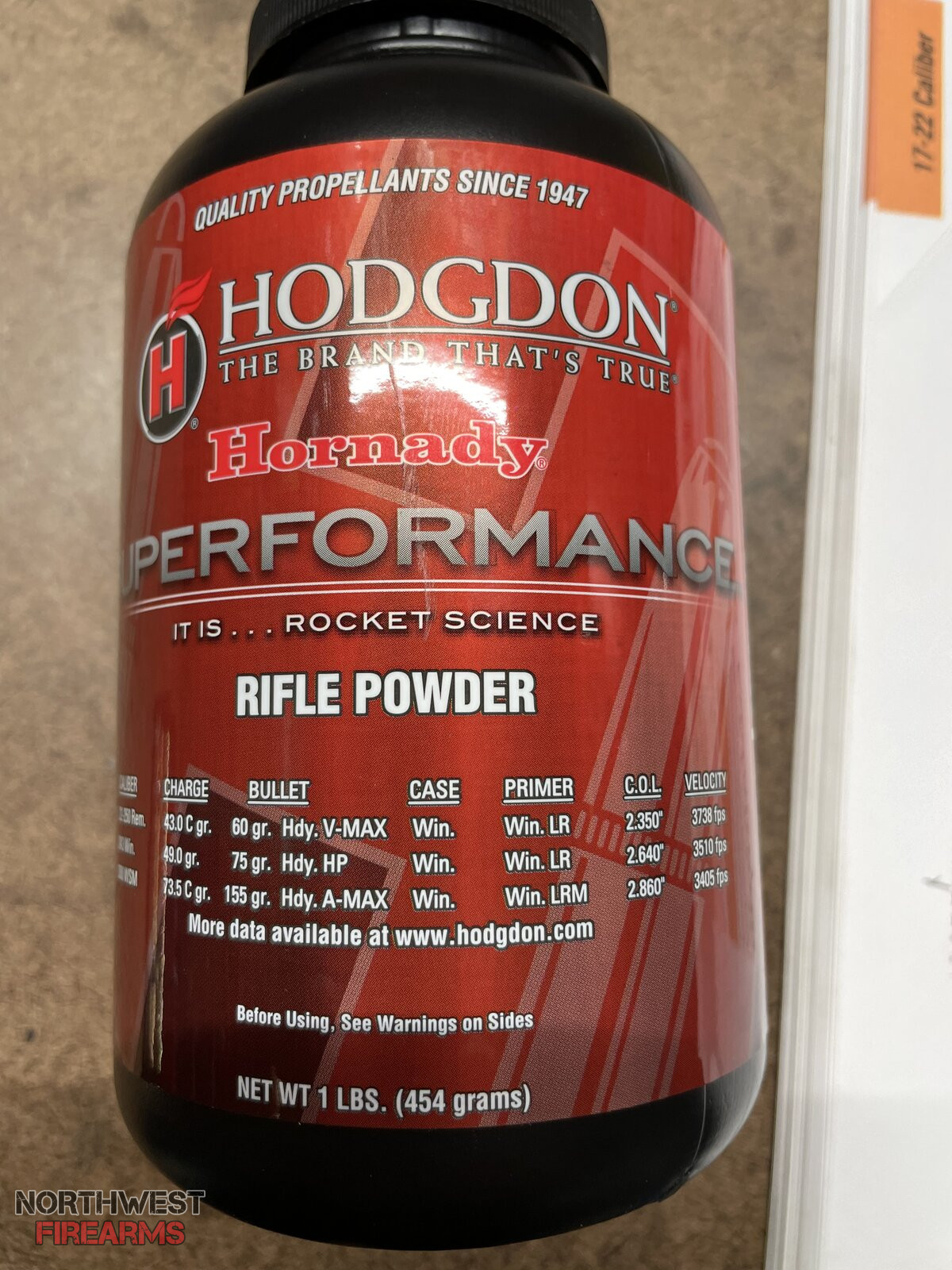

Picked this stuff up today for 22-250. Has anyone started working with this? It's not in my book….50th Lyman. Data it printed on product label. I see only a few bullet weights….
I tried it several years ago just after it was first brought out. It was underwhelming at best for me.
It is not the same Superformance that is used in Superformance ammo. The ammo I do like, and I have chronographed significant improvements in velocity with the ammo.
