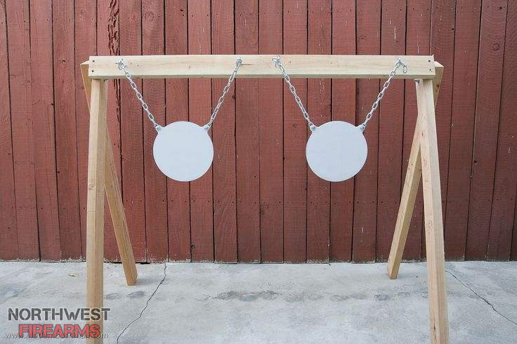

I started with these
U.S. Ballistics Steel Target 3/8 AR500 Gong 8 - MPN: AR500-ROUND-8
And mad some stands like this for $21 each
These work for hand guns and are only $8 each

If it helps, I have some 4" and 8" steel in both circles and squares to clear out at cost and have found a resource to get much larger plates of AR500 3/8" if you want to set something a long way out. They come with a nice white powder coat! Hang with 1/4" braided cable and you are good to go.
Jeremy
You think using bolts would work instead? That way I could disassemble it for transporting. My cherokee doesnt have enough space to store multiple all put together. Ill (hopefully) have a good basket/rack that would work beautifully as long as they could come apart.
Bolts would work just fine, there are tons of plans out there. Several people use PVC pipe as well. If had to disassemble for transport I'd probably go that route and just bring some spare parts with me. Steel targets are one of the best investments for fun shooting. Also pick up several cans of cheap white spray paint

This one is the best in the business, IMO.
No welding, chains, bolts, 2x4's, fire hose or rebar !
Just an ultra-clean, smart design that uses inexpensive 1" EMT (electrical conduit).
It breaks down into individual components for easy transport.
Designed by an engineer from NoCal (Price, Design and Engineering)
His website is down presently but here is a video that shows exactly what I bought from him...
