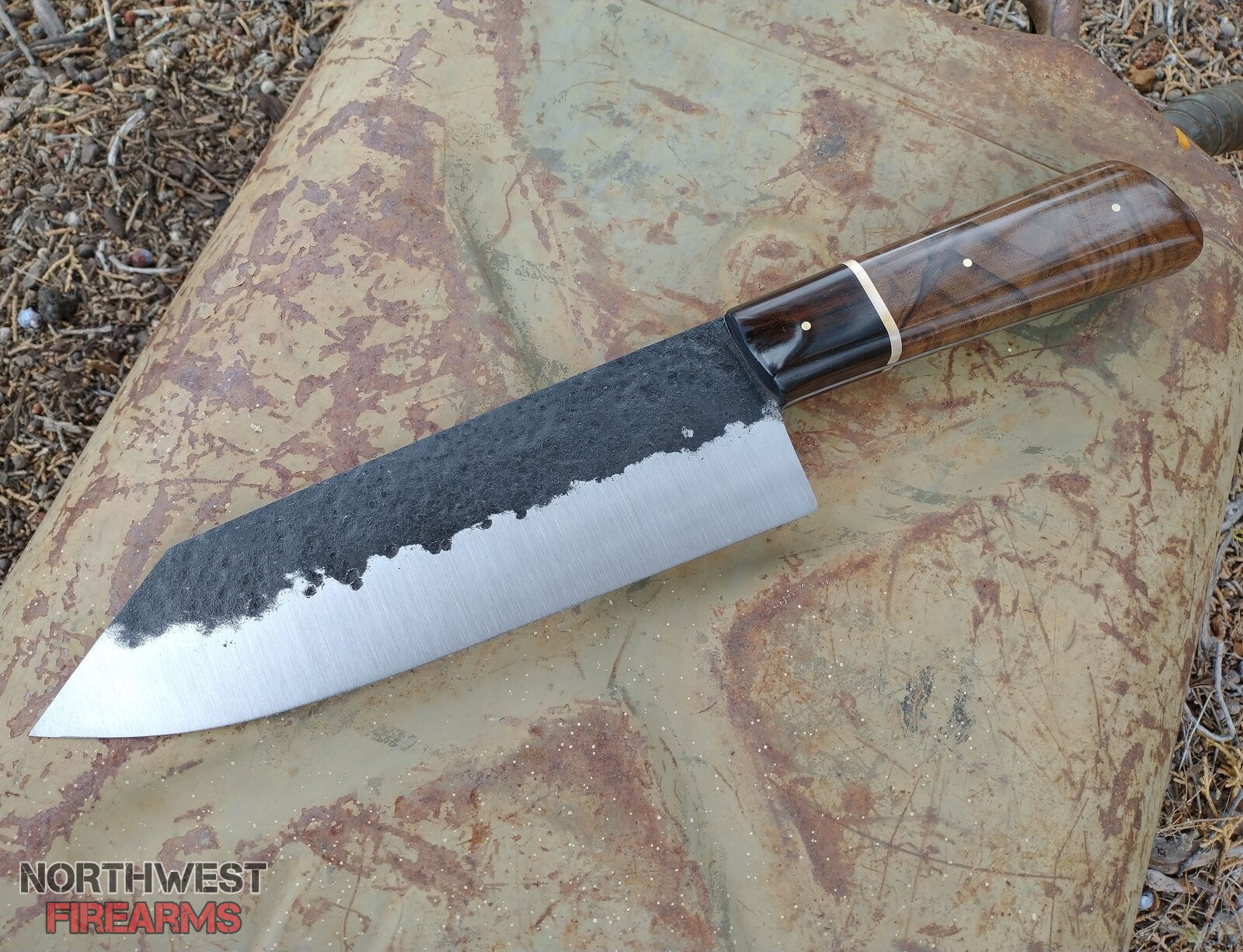

If you want a permanent sealant, ca glue works really well. Tru-oil will also provide a more water resistant finish than blo or Danish. I use mineral oil on my natural wood handled kitchen knives.
Here's one I did with a ca glue finish.
