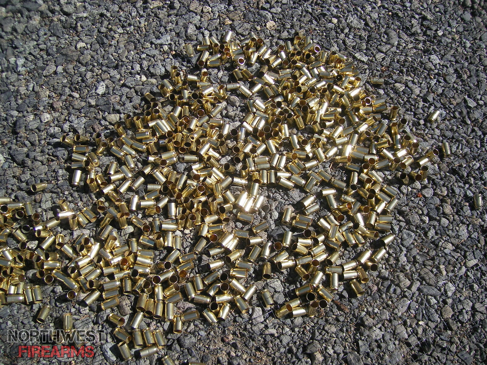

When I started doing the wet tumbling thing, I was impressed. Now not so much. For great shine I've got back to corn cob media in a vibrating tumbler. What am I missing with my soap formula? That has to be the problem. I do love my shiny brass...it shoots better!!!
I use a couple tablespoons of Dawn and a tiny squeeze of Lemishine when I have it.
Thank you.
The pins. I have discovered that running smaller batches with the SS pins works better. I've been running 250 .223 cases at a time. That may be too many.
It just needs to go longer; it depends on the amount of brass but also how dirty it is. I usually check the cleanliness after two hrs in my set up and if it isnt good enough I let it go a while longer. Just need to make sure there is enough room in the drum for the brass to tumble and not be locked in place too much as the other brass actually helps clean the outside not just the pins.
Good advice deadeye, I'll go back to the basics that sold me on this type of cleaning in the first place.
I have the larger Frankford wet tumbler.
I fill.it about 3/4 full of brass.
1/4 teason og lemishine booster
A cap of ArmorAll Wash n Wax
A small squirt og Dawn dish soap.
Hot tap water
Let it run for an hour.
Drian the dirty water off and rinse until tje water is clea.
Fill back up with hot tap water, add a cap full.of ArmorAll Wash n Wax
Let to run for fifteeninutes ,
Drain & drry.
I knock the primers out before I tumble
I use a vibrating tumbler for no more than 100 cases (or there about's) at a time. Works fine. A few hours at most. I use an old rotating rock tumbler of about an estimated gallon size (two sides 1/2 each) with one quart water, a 1/4 cup vinegar, and a squirt of Dawn for large runs of brass, or really tarnished. The worst cases will clean up. It's a matter of time. I once had a large batch of .45ACP that was essentially black. I let it run all night, looked brand new and was dimensionally fine. You do have to leave enough room for the brass to throw itself about as trying to stuff too much in there is self defeating.
Thank you.
I don't really know anything more than what I've read and seen here about stainless pin tumbling. But I do know about Dawn liquid dishwashing soap. We buy the fanciest stuff at costco. But even plain old generic, run O' the mill stuff would be way too much at TWO Tablespoons, you said? Seems to me, "Chief Cook and Bottle Washer around here, that two TBSP of dollar store liquid would be too much. The thought occurs to me too, that dish soap is a grease cutter. Not a lot of grease on dirty brass.
The hot tap water helps with the cleaning procrss, when you hands are dirty you use hot water.
You ask a hundred people you get a hundred answers.
What ever works for you keep at it.
I'll stick to my procrss.
