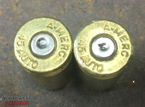

Like I mentioned before though, there is one type that goes straight into the recycle bucket. I actually found a couple recently, hadn't seen any in quite some time.

Haven't heard of A-MERC before, why do you toss them, why do you consider them inferior? enquiring minds want to know...
Back in the day when I first started loading random range brass in .45acp and 9mm, I began to notice a trend. Nearly every single time I had a malfunction with my reloads, the brass involved was headstamped "A-MERC". A friend then showed me some ammo he bought at a gun show that malfunctioned terribly in his 1911- factory ammo with the same headstamp. A google search shows that it's a common complaint: terrible quality ammo.
I did read somewhere that they had used different components over the years and some of their brass isn't that bad, but I don't take chances with it, and just scrap any I find.
