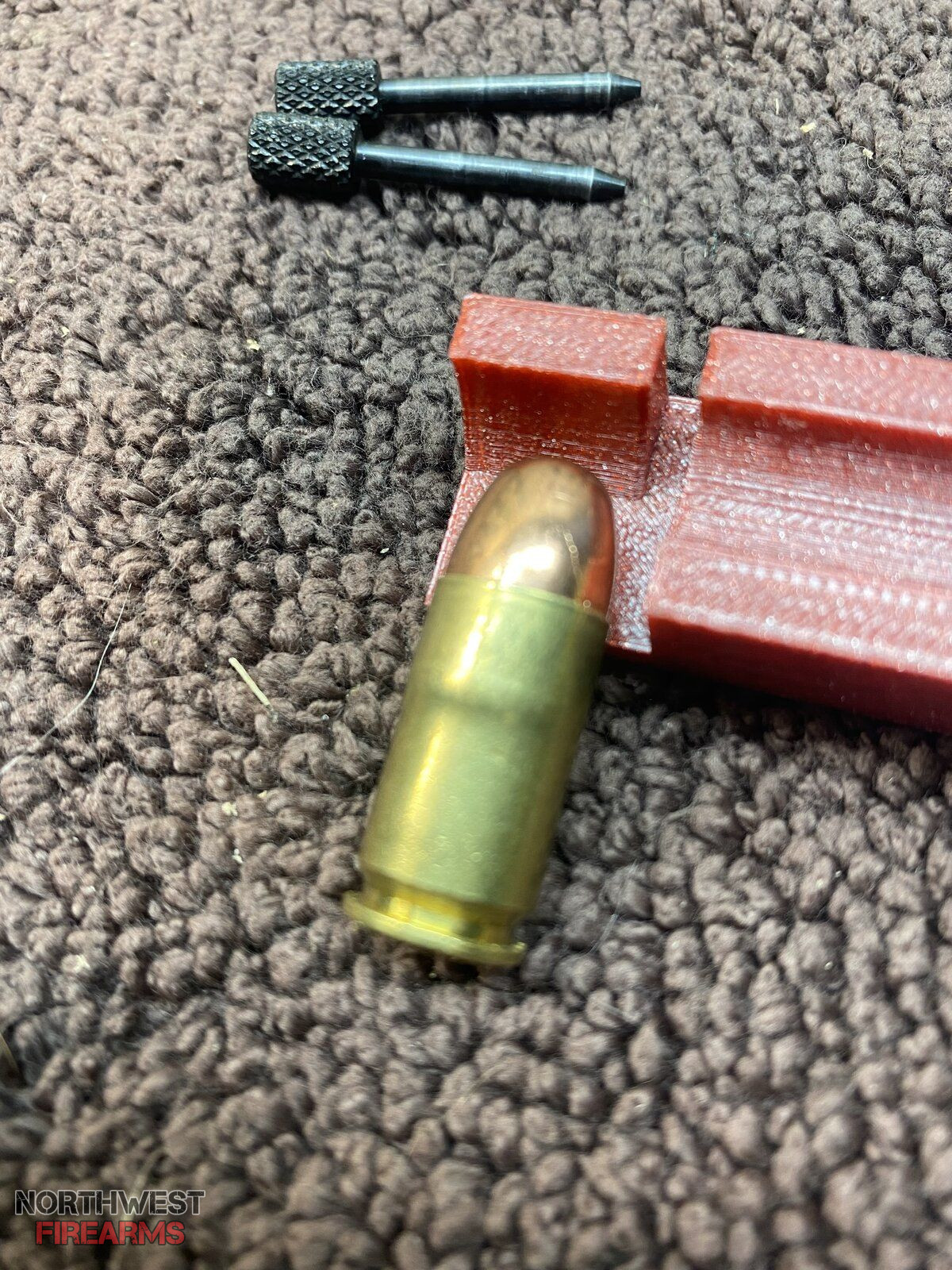

THEY SUCK!!! Just loaded a couple hundred .45's and found 4 that have severely deformed cases (case bulge like putting the bullet in side ways). All 4 were A-MERC. Tore them down and measured them. Turns out the case OD is fine (obviously, or they wouldn't fire) but the ID is .435 inches. Case wall is .016 (normal is .012), so the .451 bullets swell the case to the point they won't fit in the chamber 🤨.
Sorted a couple thousand rounds and found a couple dozen. My grandson now has some brass to melt.
