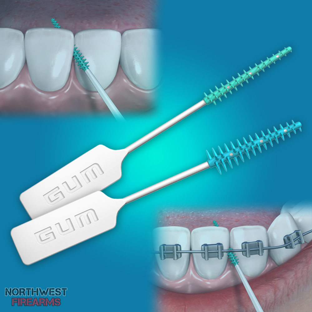

I was given a tooth pick holder my a dentist many years ago for getting in to spots not accessible straight in.
Stick a wood pick in one end, tighten the collar and break off the excess.
A good concept but I never really used it for my teeth.
One day I was having trouble getting at some grit in my gun, and didn't want to make a federal case tearing it down to get at it.
Although I had to drill out the tooth pick hole in it just a tiny bit to accept the Q Tip size, it has since become one of the handiest tools in the cleaning box.
1687813375652.png Up to you to picture Q Tips in it :rolleyes:

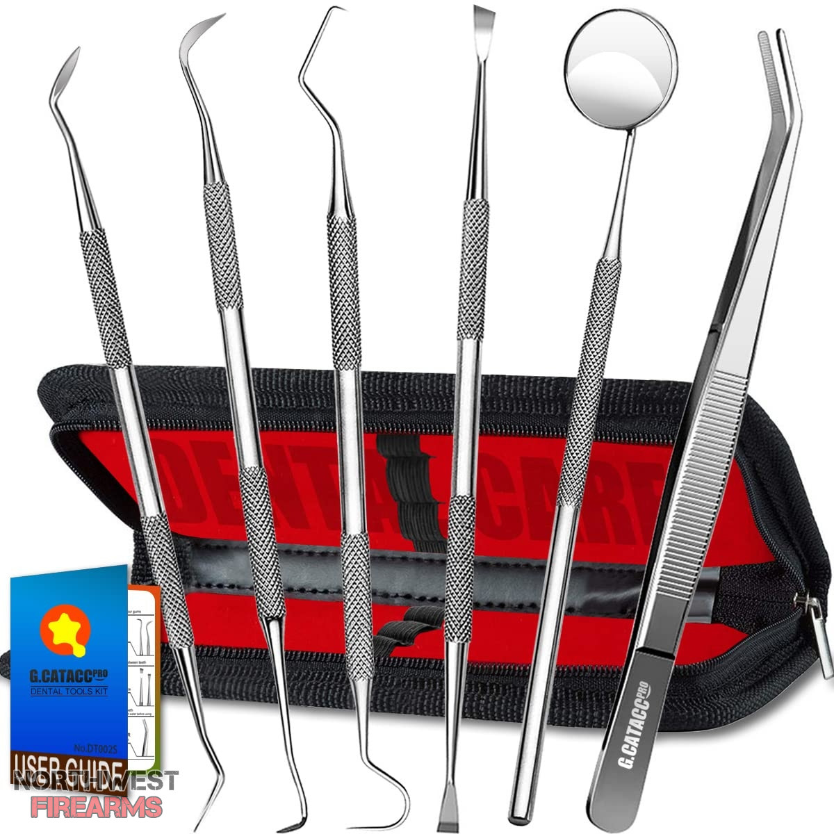

Dental tools are a blessing too. Got a set off Amazon for picking at my teeth. However one that didn't get used for that ended up in the gun drawer with the rest of the cleaning supplies. Just don't use them for both!

That was going to be my suggestion.
If you need a non marring pick I just put a piece of heat shrink on it and use it till I want a steel pick and cut it off.
Rinse and repeat - heat shrink kits are about $9 for a very large variety 1000 pack on amazon.

Can't beat dental tools for getting into the nooks and crannies…. Have a set in my gun cleaning kit, as well as tooth brushes.
My guns have the best teeth and gums :s0140:
