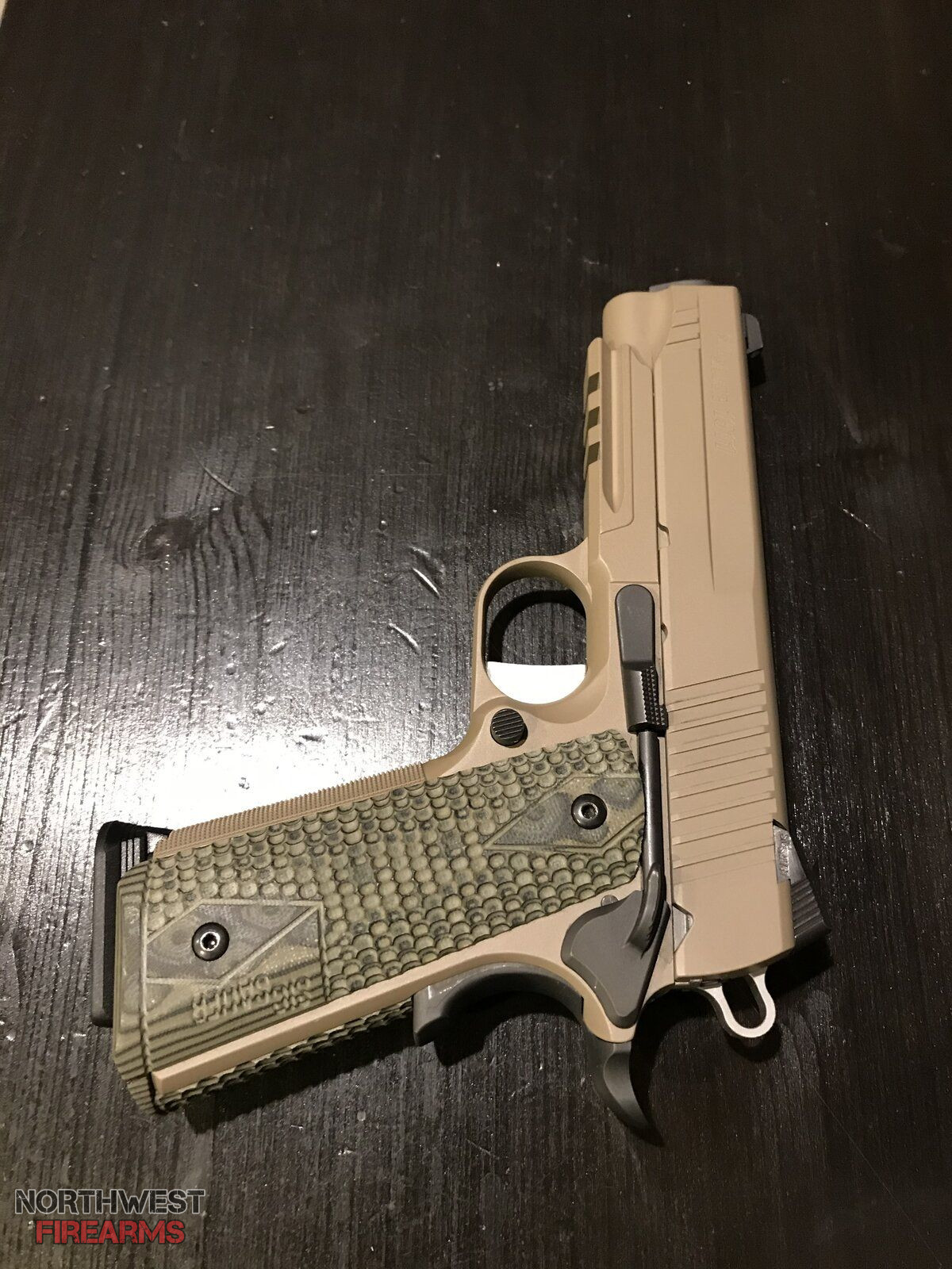

I'm having serious issues with my sig. after about 4 or 5 mags through it the slide does not lock on the last round fired. When I load a new mag with the slide locked it jams when I release it. I have ocd, so the gun is very clean and properly oiled. It shoots great after cleaned, but not for very long. Someone tell me something.

Gun is practically new. 4 new sig 8 rounders with slam pads. Winchester, Remington, and federal 230 fmj
