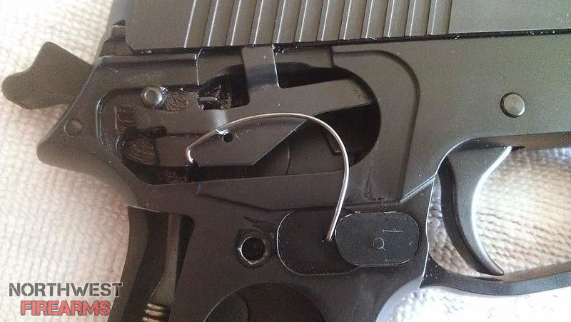

An oldie but a goodie. Since I've owned it, it's had an interesting issue where the gun will not fire after it's been decocked. (Granted, I'd probably be a bit gun shy if I'd been decocked.)
Jokes aside, here is how the gun currently functions:
Rack slide, chamber a round, pull single action trigger, the gun fires as it should.
If you decock the gun after chambering a round, then pull the double action trigger, the gun will not fire; no matter how many times you pull the trigger.
To get the gun to fire again, you can either manually pull back the hammer and fire from single action, or you can rack the slide again. Essentially, the gun won't fire from double action.
I've done a little bit of research, but nothing definitive has come up. It would seem that it's not a very common problem. Potentially a weak trigger spring or sear on an internal safety that's not engaging?
Any sig gurus have an idea as to why this is happening?

The decocker has to deactivate firing sequence or the dropping hammer could set off a detonation. Clearly something isn’t resetting on decocker release. Take off the grips and see if they are either installed too tight and impinging on the reset spring, or if the spring has jumped from its detent hole. Aftermarket hogues were a problem for me similar to this on a p220.

Thanks. Taking off the grips and giving it a once over was the first thing I did. It didn't seem to help and it is using the stock grips.

In double action, does the hammer fall but won’t detonate? If so, then the disconnector is sticking in the disconnect position due to a engagement problem with the decocking mechanism. Probably it’s a spring issue. I don’t think Sigs use firing pin blocks, but I could be wrong.

Exactly, the hammer falls and it just clicks. Looks like I should buy a spring kit.

Does your trigger have a pre-travel adjustment screw?
Sounds like a bit more pre-travel adjustment is needed to let the trigger further forward in double action mode.
Just a thought.
I don't know if the P6 had a factory pre-travel screw on the trigger, but some of the Sig's did. Maybe an aftermarket trigger was installed improperly? Could be a reset spring issue as others have stated as well.

It doesn't look like this trigger has a pre-travel screw, though looking at it, I don't think it's stock. That very well could be the source of all my woes.
Interestingly, with the slide off, the firing pin block actuator does engage when pulled in double action.
