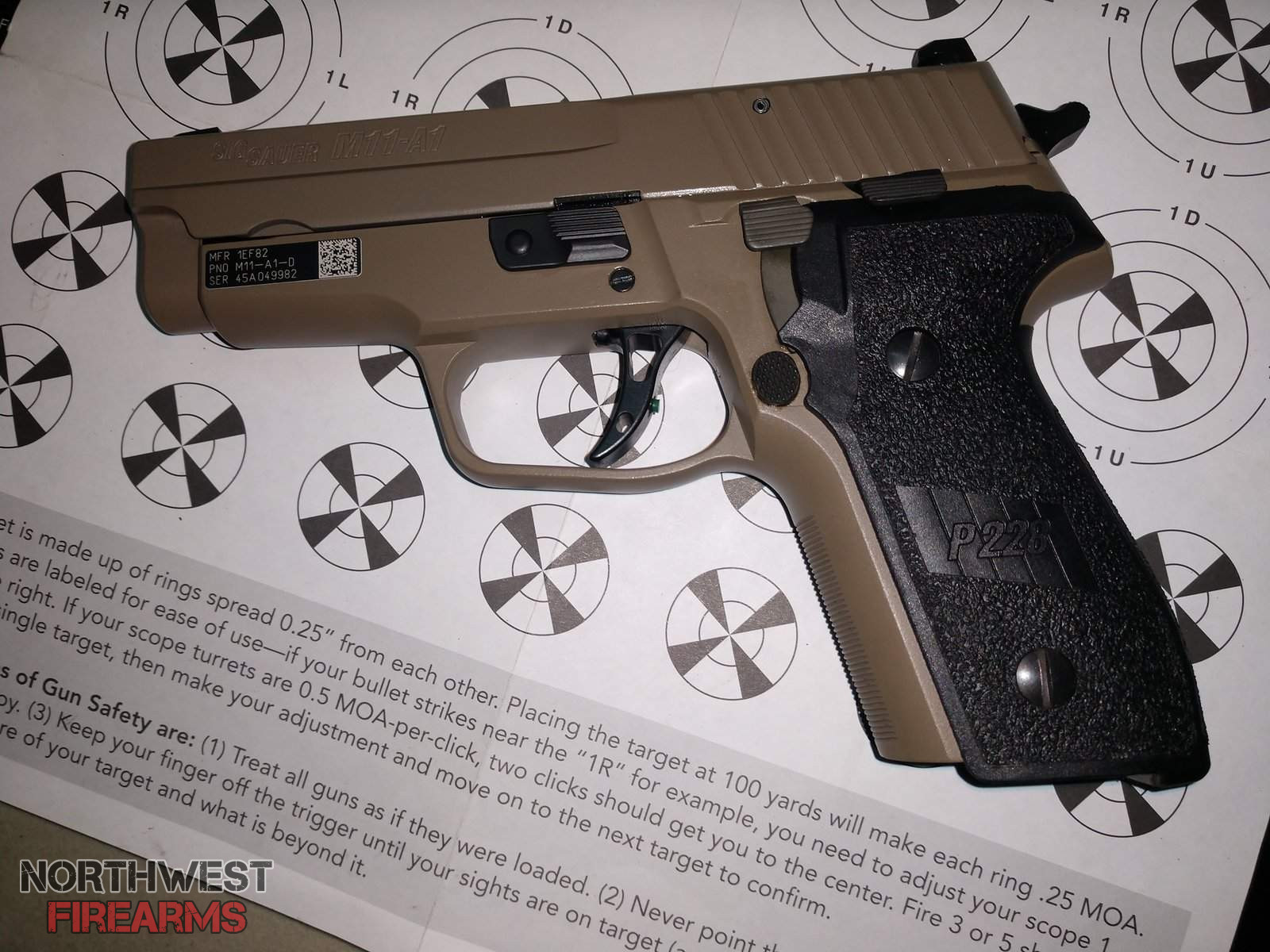

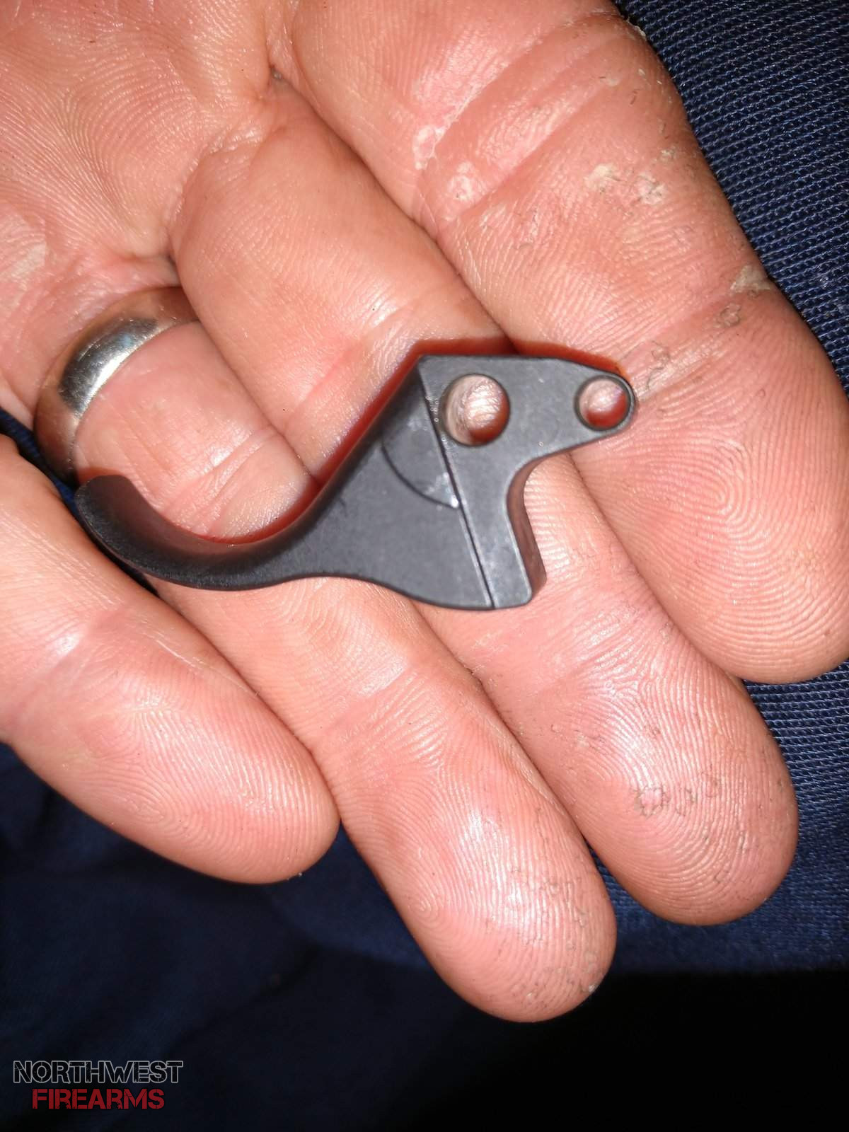

I've had my M11-A1 for a couple months and only have a couple hundred rounds through it but I do dry fire the hell out of it.

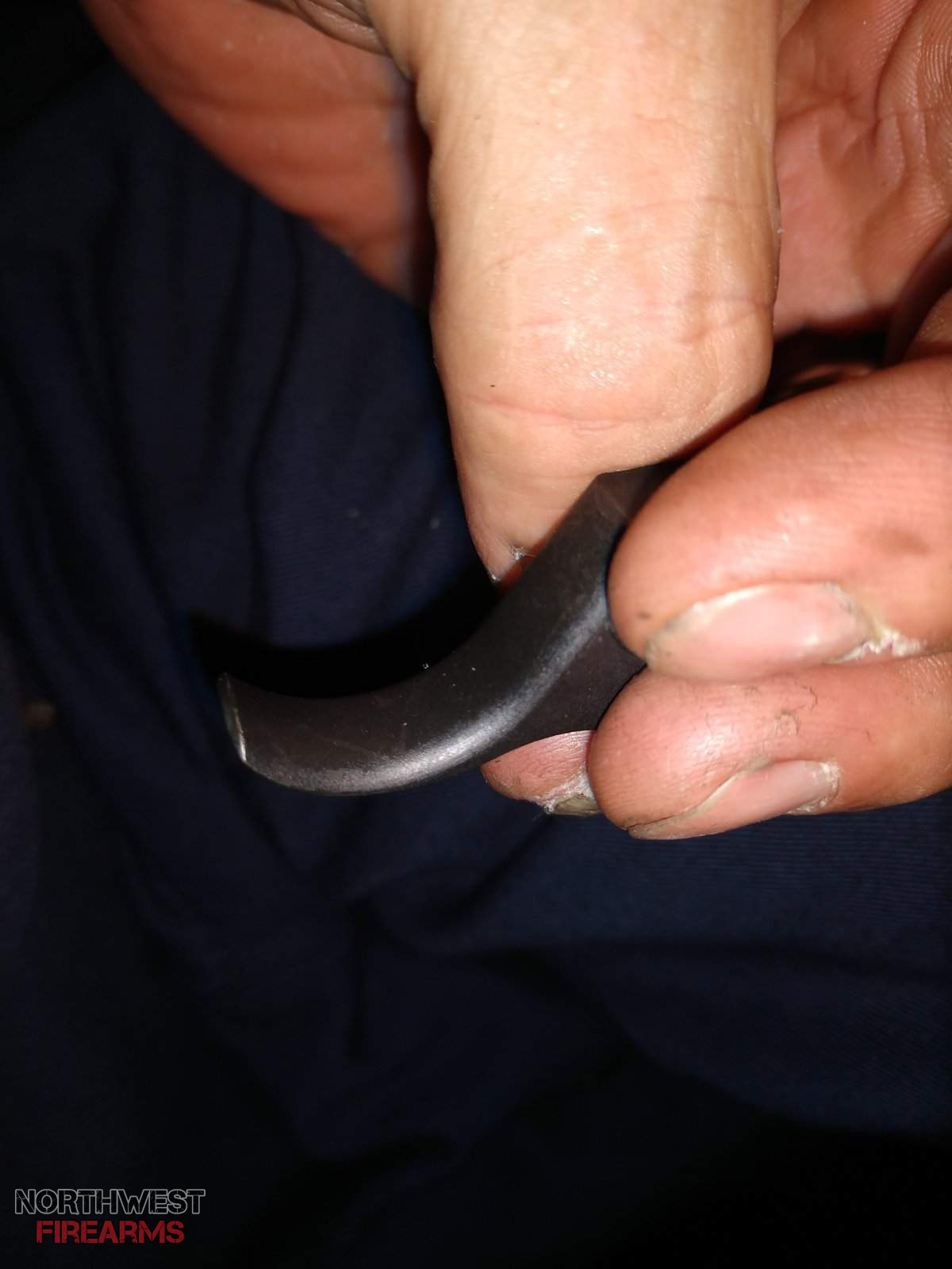

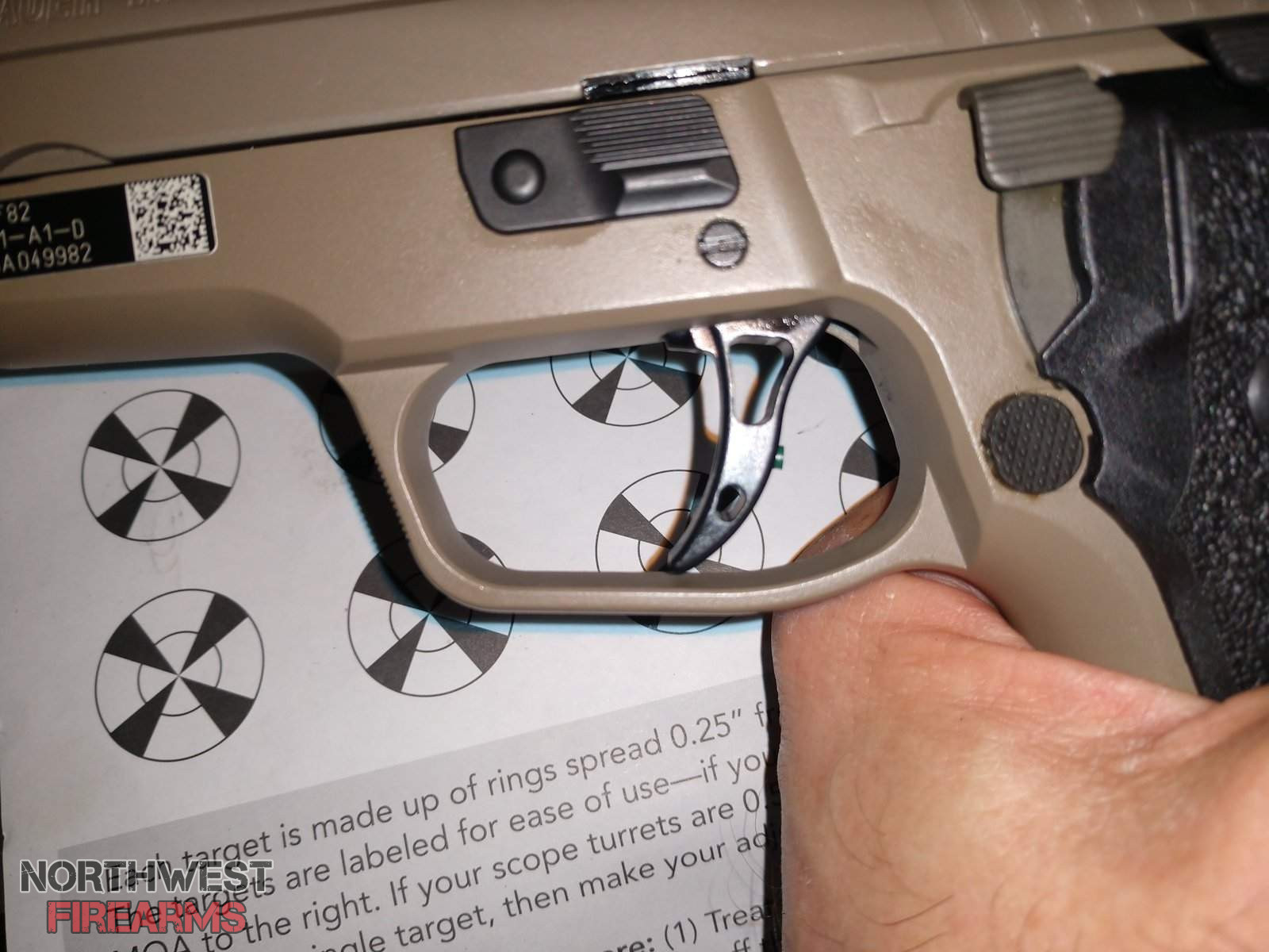

It has the SRT trigger that is great but I don't like the Short Reach Trigger that goes with it .
It's not comfortable and pinches the crap out of my finger .

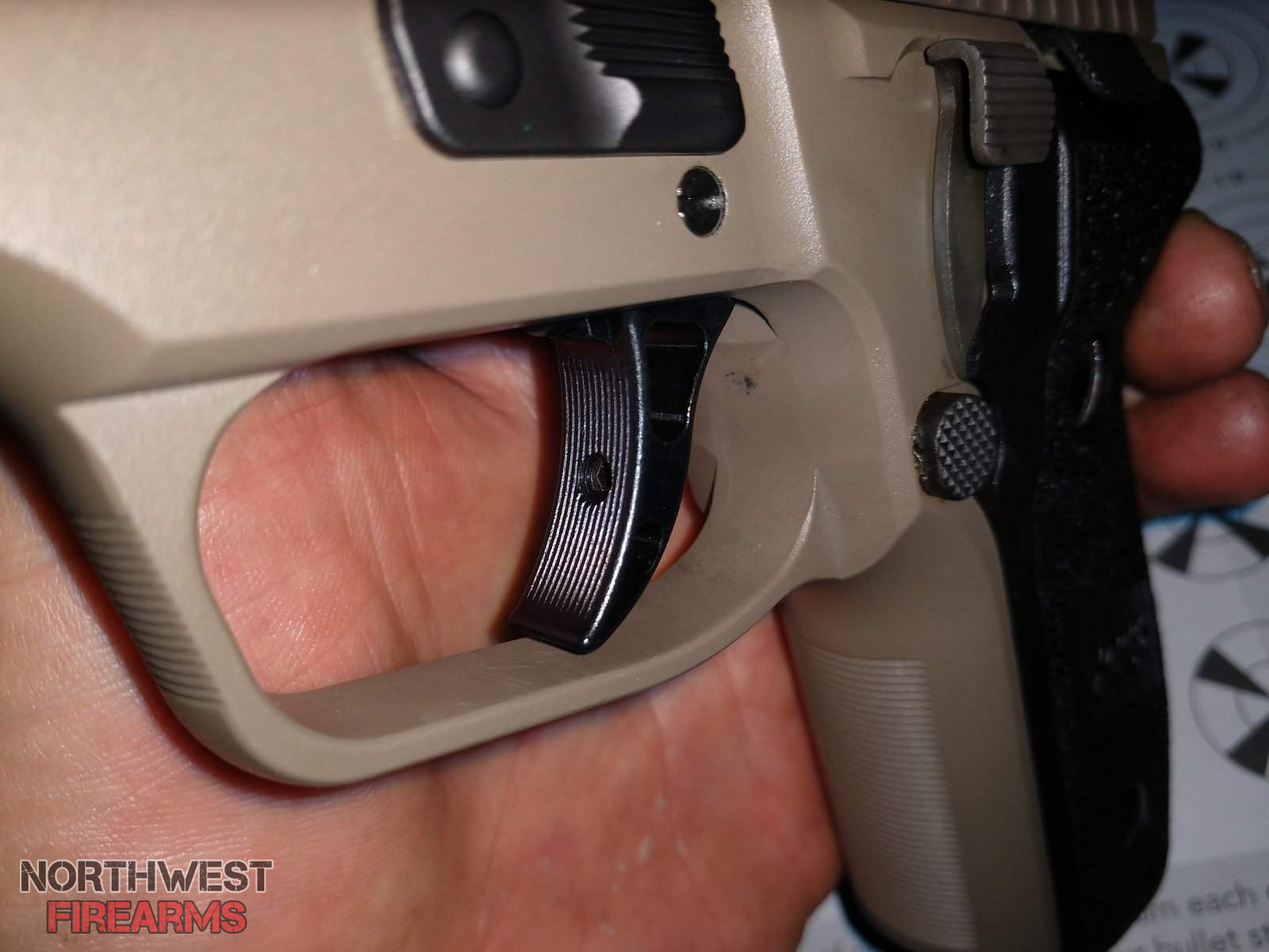

Armory Craft to the rescue.
https://www.armorycraft.com/product...-p226-p227-p228-p229-m11a1-adjustable-trigger
Should have this installed next week along with an 18lb spring to soften up the DA a bit .
This trigger still retains the Short Reset and can be used in guns without SRT .
I'm not going to polish yet, just keep working it and see if the Phosphated internals wear in
It seems that coating is a bit rougher than others and takes a bit to break in .
Kinda stiff SA at the moment, nowhere near 4.5 LBS that's for sure.
