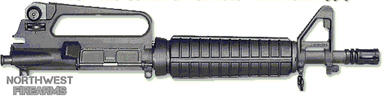

One option is the PSA offering:
Another is the Model 1 short upper:
Anyone have experience with either of these? Beyond that, any recommendations for a basic upper along these lines?

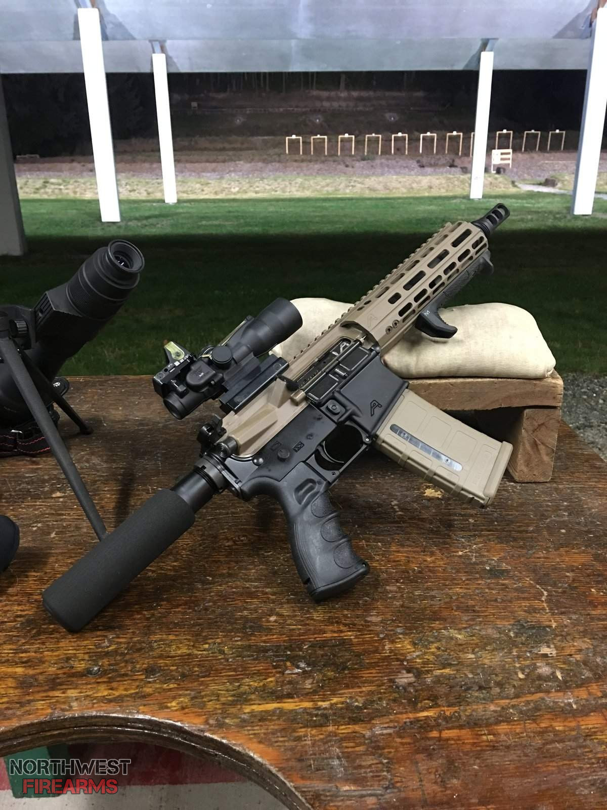

Have you considered a 7.5" barrel so your SBR can be as absolutely loud, flashy and obnoxious as possible? That's why I built my 7.5" pistol! :D
Also, I would skip anything with the built-in carry handle and front site post. Give yourself as many site options as possible. There are plenty of manufacturers besides PSA that will have an offering that works and is budget friendly. BCA, CBC and Radical to name a few.

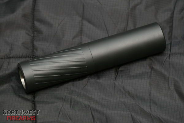

LOL! Well, it did cross my my mind to go as short as possible, but I'm going to stick with the longer one. That and most cans I looked into, including the one I eventually bought, require a minimum barrel length of 10½".
Besides, I already have a Super Shorty that fits the "loud, flashy and obnoxious" role quite well. :D

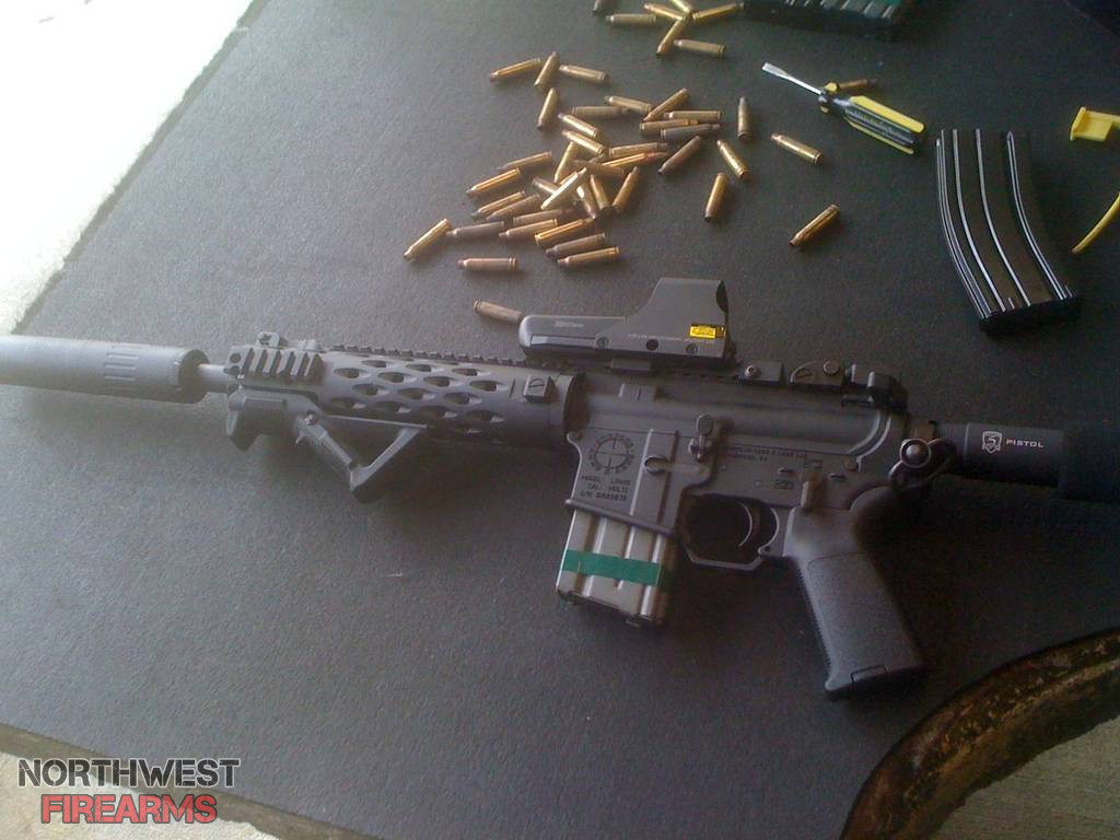

AR-pistol lower while waiting for a stamp.
SAA lower w/ PHase5 pistol buffer.
Aeroprecision standard upper.
YHM front rail
Black hole weaponry 10.5" or 11" barrel
EoTech with YHM Gasblock HK front sight, Diamondhead rear sight.
AAC M4-2000 (had a minimum 10.5" barrel length requirement)

I am happy overall with my Radical Firearms pistol upper. Nitrided 10.5 inch barrel with A2 but the free float is propriertary with a big barrel nut. I couldn't come close to getting it off they said...use heat but then I'd void the warranty...I got it for $199.95 on sale a year ago and it's normally $280-300. The Maxim machine gun look has kinda grown on me....
I will say this, for a PSA blem lower and a cheaper upper it's more accurate than I expected for the money.
