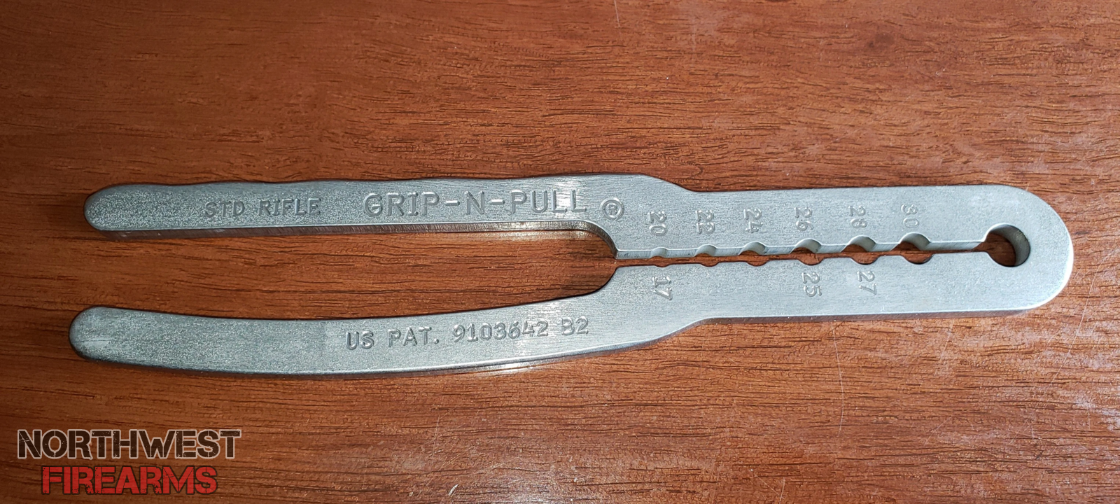

Guess I'll have to buy a $15 collet to pull down and save the $0.60 bullet 😆
Depending on the type of press you are using, you may be able to run the case all the way up without a die in place, grab the bullet with a pair of pliers and lower the case while bracing the pliers on the press. I've done that just to speed things up before when I wasn't interested in re-using the bullet. :D

Or use one of these. You need a press for it to work, and saves the bullet. I have two for different calibers, works great and is fast.
Neat! I've got a collet puller but never seen one of those. Nice that you don't have to have a dedicated collet for each caliber.
Not a huge hurry so I'll probably just get a proper sized collet. Likely I'll need to pull down some more in the future, and would like to not tear up the bullet.
Never seen one of those before. But definitely would work conceptually like my pliers. And saves the bullet - nice. I've got a puller with some collets, as well as one of those "hammer-looking" inertia pullers but they are a lot more trouble than "grip it and rip it".
