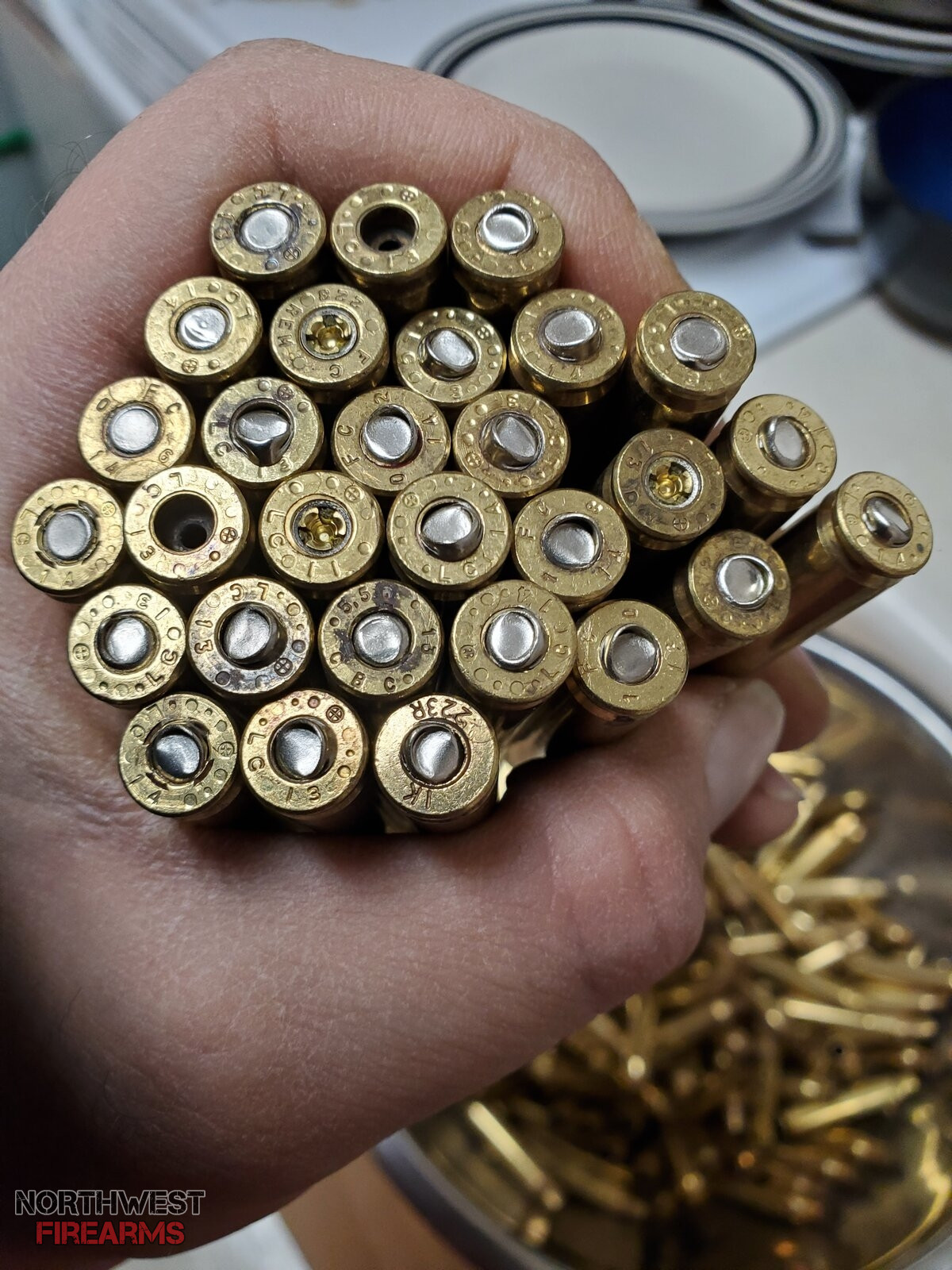

And that's exactly why you don't shoot someone else's handloads. Honestly, I don't know if anything else in the bucket will be usable. Even the ones I haven't tossed aside yet all have issues. Flattened and concave primers. If resized at all, no lube was used. Shoulders and necks are stretched. If I use any of this brass, I'm gonna have to undo what's been done and start from the ground up.
Attempted to prime without swageing crimps. Yikes...

My mistake today: traded for "ready to load" primed brass. Seems like a nice kid and doesn't know anything about reloading and just happened to come across this bucket. He even kicked me $20 back upon initial inspection, but it's way worse in this bucket than I thought. 6 out of 26 pounds look like this or worse:
That will keep you occupied on these cold wet winter days.
What about running it thru the sizing die and wearing safety glasses to punch out the primers? Just a thought if it's not been suggested already.
I do plan on trying to save what I can. I'll decap the live primers that are mangled and it looks like I'll have to resize everything anyway. Some that still have decent primers I'll resize without a decapping pin. I'm a little concerned bout the pressure created in the chamber if firing the ones where the shoulders got stretched too much. Still not sure if I'm going to try to load the ones with pancaked and concave primers (if they'll resize right in the first place). A lot of them need to be trimmed too, but I wouldn't start to address that until after I resize it all. Definitely a back- burner project now, I've got plenty of brass steps ahead.
The pancaked primers won't be an issue
Resize them popping out the damaged primer out. If the resized case fits a chamber gauge swedge the primer pockets and load away.
Our guy made right on his deal and kept his word for the brass he gave me. I'm going to feel a lot better about it if I have to scrap all of it now.
