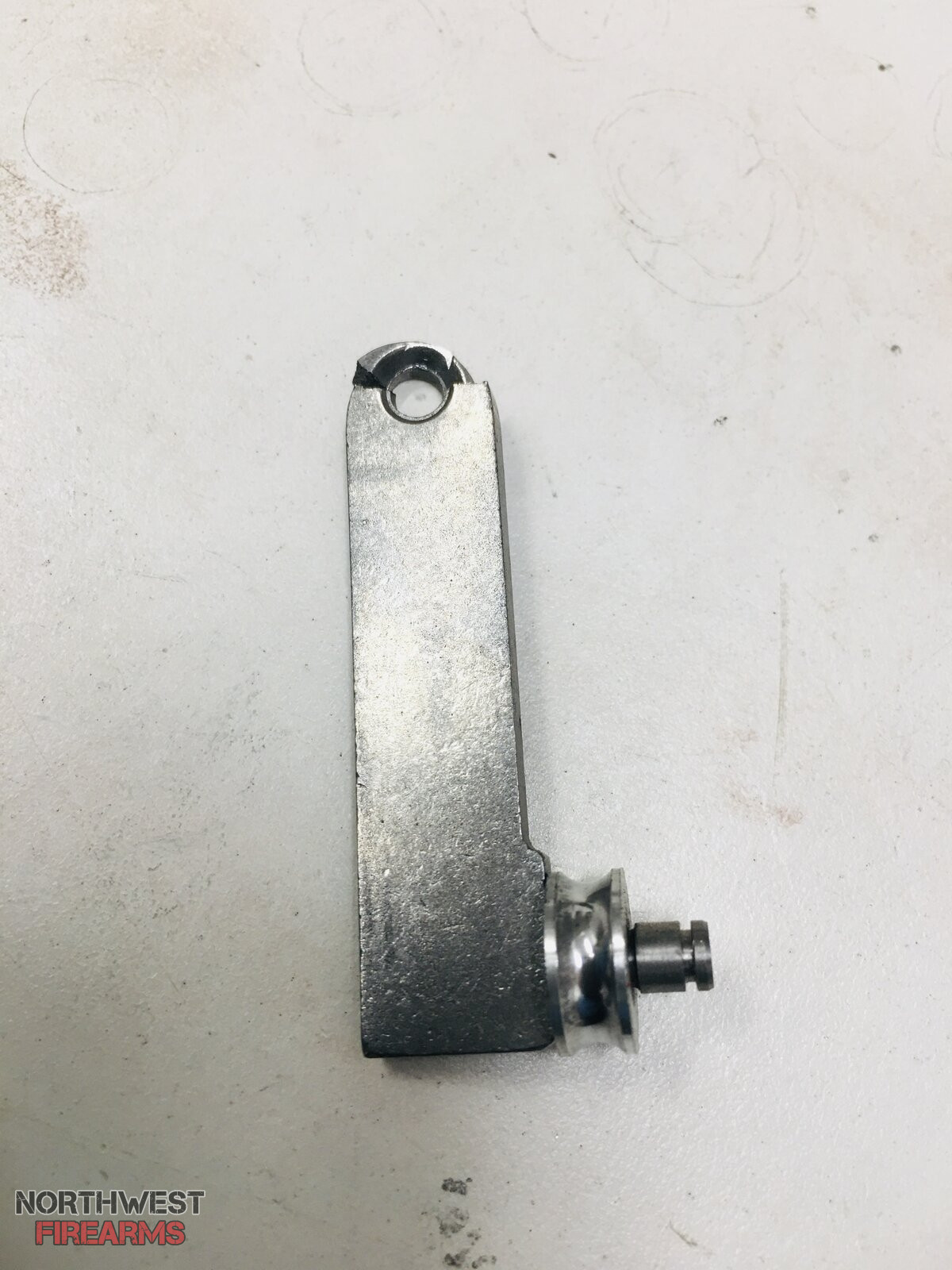

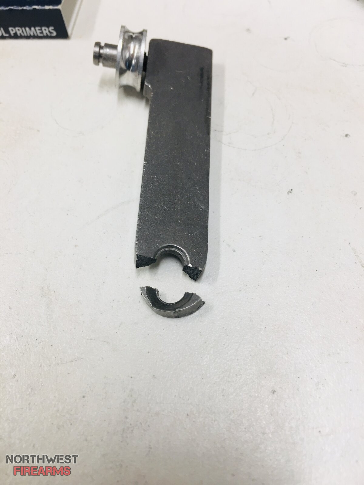

Well, I had the first problem on the new to me Hornady LNL AP today I was loading some 357 rounds, I was actually priming on the press which I have not wanted to do but figured I'd venture out on this run.
I was close to the end of the run when I was pushing in to prime the case, I felt resistance and pushed on and heard a very loud snap!!! I did deform the primer, but it did not explode it thank goodness I would not have wanted to use bleach to clean my clean room.
Upon inspection, I found that I broke the tip off of the sliding primer loader thingy. :eek::eek::eek::eek::eek::eek::eek::eek: WTHHHHHH!!!!!
I guess I am going to find out how good Hornadys warranty is on Monday.
