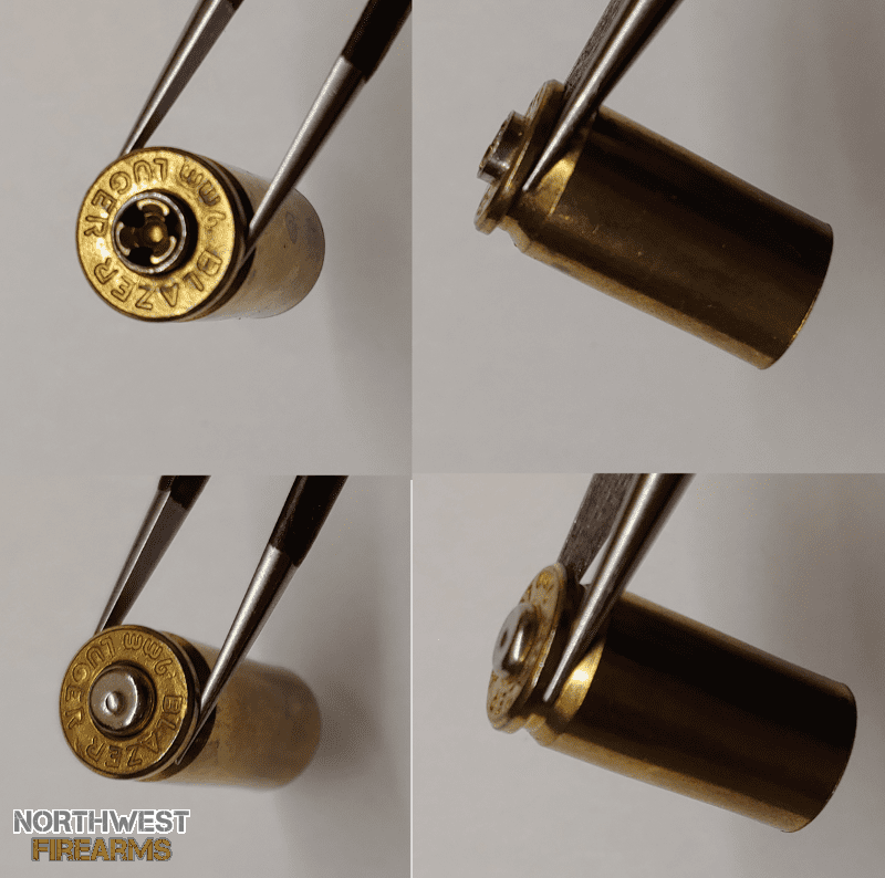

I am not doubting you, but really? Why? I hate the residue from primers I have decapped. I am curious as to the rationale. I guess they can't plug the primer hole. I am ashamed to admit I don't know what the metal is but has to be harder than the brass?
As weird as it sounds yes I have seen this posted online before. On one hand it almost makes sense, as the premise is rubbing stuff together to polish it, and what reloader doesn't have a near infinite supply of spent primers on hand?
however it is foolish, as has been experienced by @awshoot. I don't know if maybe they were smashing them? But not something I will ever attempt as we now have first hand experience that it not only doesn't work but also defeats any savings.
Here are two cases, top and profile. Most of the primers went back in the right way rather than upside down. I would have thought the rounded corner on the top side would have made it easier for them to go in upside down, but nope -- only two or three out of the 20ish are in upside down. And while it seems like they could be pulled out, I can't. Not even with tweezers. wetTumbledPrimerIssue.png
Here are two cases, top and profile. Most of the primers went back in the right way rather than upside down. I would have thought the rounded corner on the top side would have made it easier for them to go in upside down, but nope -- only two or three out of the 20ish are in upside down. And while it seems like they could be pulled out, I can't. Not even with tweezers.View attachment 752185

As for wet, I can say for certain that spent small pistol primers will work their way into a small primer pocket -- not all the way but far enough that I can't pick them out with my fingers.
I have previously mentioned using spent primers for wet tumbling but only on brass as my 'pre-cleaning' after shooting or range pickup with the spent primers still intact.
For this it works excellently and I don't have to worry about losing pins for just a quick pre clean procedure.
That makes sense -- the pockets still have a spent primer in them, so nothing can get jammed.
I once experimented with DEPRIMED brass & primers as media and a few got stuck but it was pretty inconsequential and the few that did get stuck either fell out on rinse or during a 'shake' in the colander to separate them.
They of course do not clean the primer pockets so no practicality anyway using them on deprimed brass but as a pre clean media they work great!
