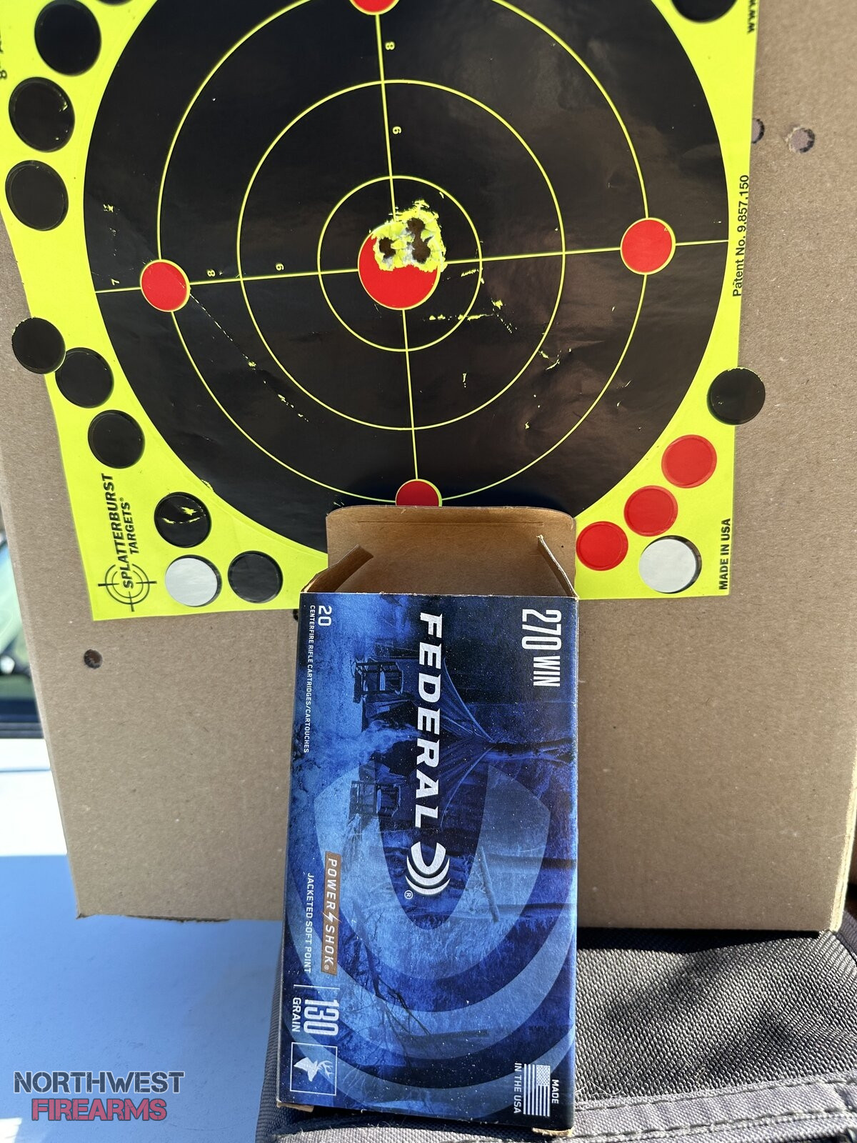

A little bit shaky today at 100 yds, looks like the 3 dollar bill space (barrel to scope) works.
Guess I'll take it and go with it.

It looks like the clearance is enough on the OPs rifle, glad its worked out.

I am not a competitive benchrest shooter. But if my hunting rifle shot groups like that with a decent hunting bullet, I'd be done experimenting and roll with it.
Especially with factory ammo.

BTW, great group, shaky day my :s0066:
