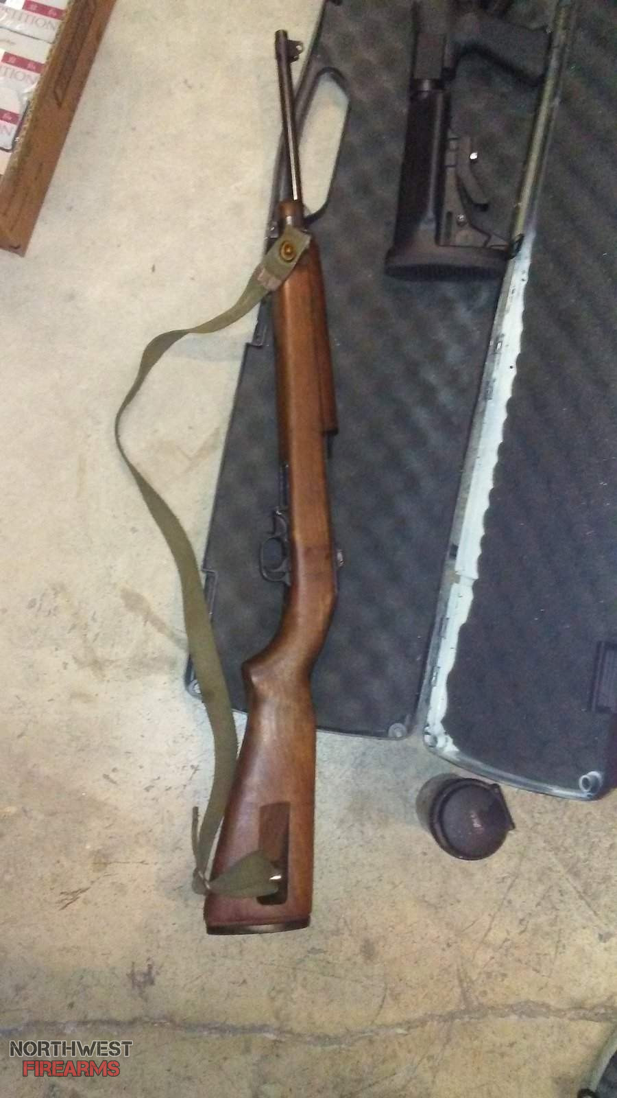

It's nothing to write home about. It needs a new rear sight and a real butt plate and a few screws. I'm hoping to shoot it tomorrow to make sure everything functions before I start reloading for it. I have some IMI soft points. Message_1489290644121.jpg

Thank you:). I didn't get to try it this weekend my parts don't get here until tomorrow. I'm waiting for a buttplate and a rear sight and a couple screws. Everything seems to function/eject and the firing pin works on a blank. I want to try some of the IMI factory ammo I have before I try loading for it.
