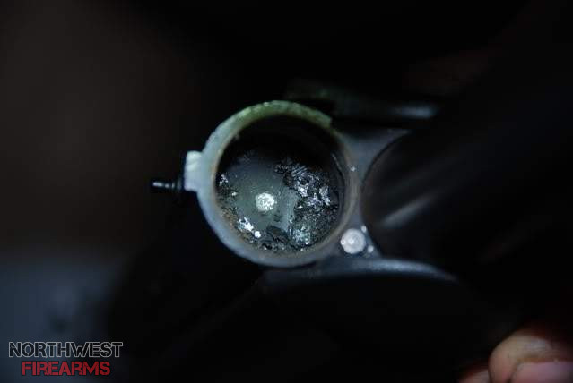

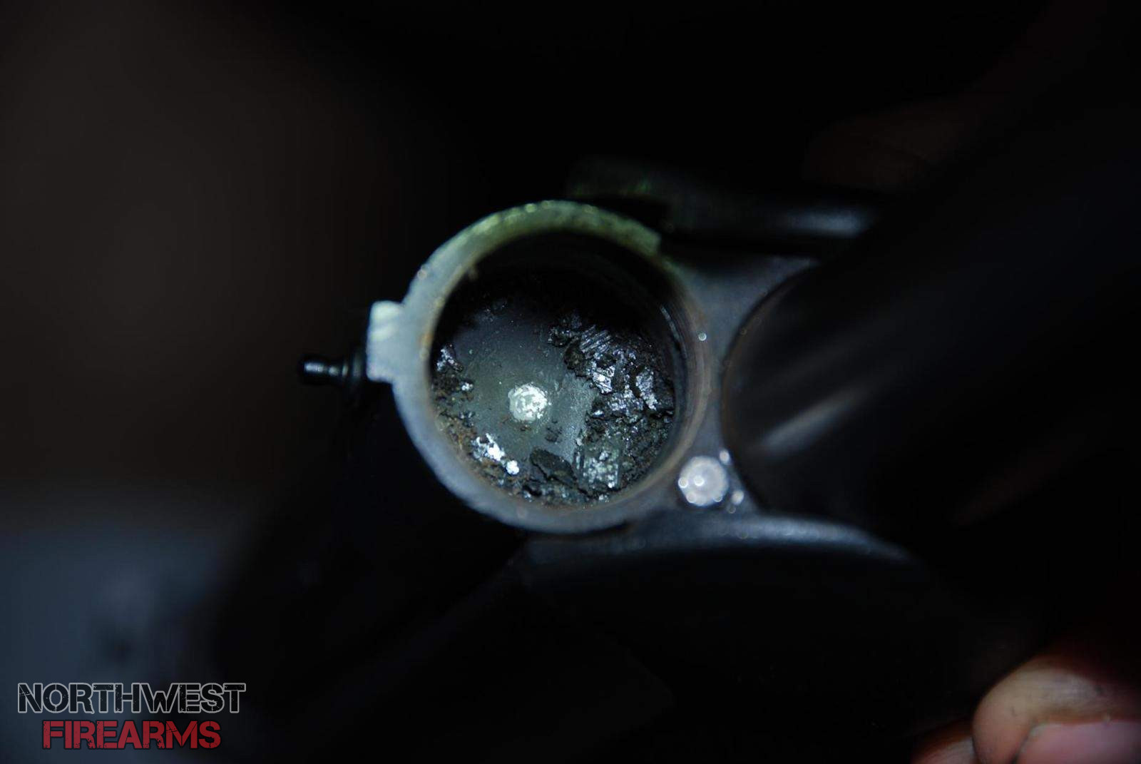

Function. I was stove piping, with low brass ammo. This is the most fired firearm I have. It's been getting worse, use to eat that stuff up. I am pulling it apart and checking the gas ports right now. Never paid special attention too them while cleaning. I still would like to swap a few things out.
Well I think I might have found my problem. I am almost embarrassed to post the pic, but maybe my mistake will help another noob. I have put about 1000 shells of the low brass ammo through this Saiga. I also had my gas setting on 2 and fired a bunch of magnum 00 buck through it. I didn't get the manual with the saiga when I purchased it from my buddy. He told me 2 was the all purpose setting. I should have further investigated.
You might also check to see if any of your gas ports are blocked by the gas block. They are generally blocked to some extent, and also usually undersized. If they are, your best bet is to remove the block, grind it out, and properly size the gas ports. The saiga forums are a great resource, or drop me a line and I can help you out.
