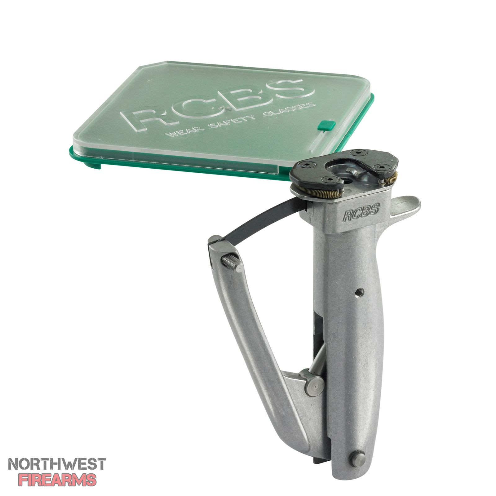

I was using a Lee hand priming tool, as I have for 15 years... priming some .45acp cases.
Sometimes I get a little resistance with my Sellier & Bellot brass, primer pockets are tight. Never an issue. I just give a little more pressure and its all done.
I thought that was the case here... So I gave a little more pressure... and the primer ignited and maybe a couple more???? It blew up in my face... got a couple cuts on my nose.
After making sure I still had a face, I went back and found the priming tool... the cover had been destroyed, probably what cut my nose?
Anyhow, here it is..... Good thing I didnt get shrapnel in my eyes.
On another note, these were Federal 150 large pistol primers... seems they were out of spec and the tight S&B cases were not the issue. I found the primers were deformed and had trouble in all cases, in fact it was a Winchester case which was in place when it blew.
Closer inspection, there were many that were not perfectly round. The edge would catch the side of the primer pocket and tear apart when I compressed it. This was my last pack of them... thank God. I wont be using Federal Primers again
