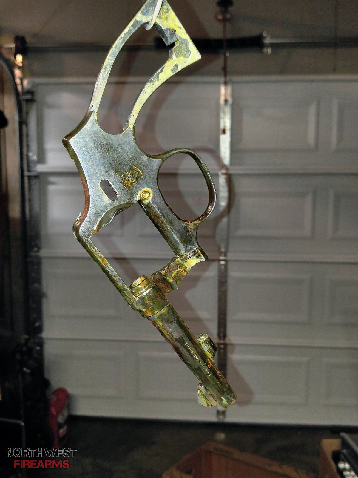

It was chemically stripped of old bluing, some imperfections buffed out & Reblued using the 'rust bluing' process.
Done myself.
Its not common, but an excellent finish, Ive done it on several muzzleloaders and it holds up perfectly against BP corrosiveness. Should be bulletproof on this gun. Its not a coating like Dura or Cerakote but similar to the way traditional hot bluing works
Done myself.

Its a little of both.
once the metal has been cleaned, degreased, etc... you apply the solution to the metal and let it sit for a while (depends on temp & humidity)... once the surface has a uniform layer of rust over it, the part is them boiled in distilled water for a few minutes... after which the part turns black.
Remove it from the water and remove the black layer with steel wool.
Reapply the solution, and repeat until the color is acceptable (after boiling)
Rinse thouroughly and soak the parts in oil to stop the chemical reaction that causes the rust..... clean it up, reassemble.
This particular piece went through the process 8 times before the color was right.
The product was "Brownells Rust Bluing Solution"
Stripped and ready to go....
First application.....
Soaking in oil after final boiling...
