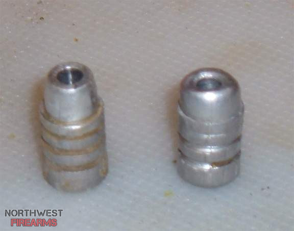

My cast and sized .357, 145Grain HP work just fine with 5.5garains of Accurate #7.
It's a "compression load" with that heavy bullet, but they shoot great.:)
