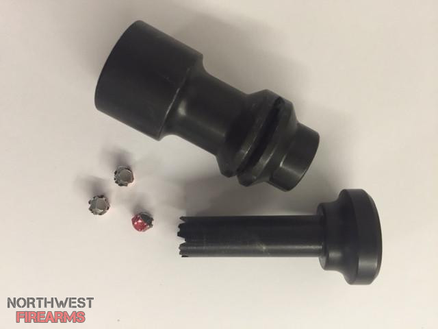

I'm guessing your powder ignition source for that rifle was the proven #11 percussion cap pushed onto a nipple designed for #11 caps? The source/s for #11 caps has been so spotty (and expensive). That is the main reason I wanted to perfect the toy cap ignition method. I'm pretty sure the fat "nipple" used in the AWAC A22W is slightly tapered but that is about all the info I can surmise from studying the pictures & drawings as I could not find specs even after several hard search sessions including patent searches. The inventor didn't want to give away too much info on how it was designed I guess. I could experiment but I just don't have the patience for it any more. Getting the specs shouldn't be this hard! It's not like I am trying to go into business. I just want to build one for my personal use.

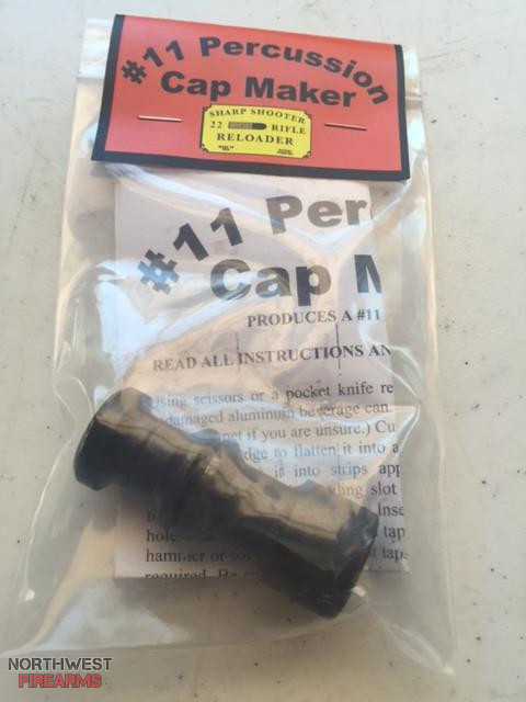

As an aside: A person nicknamed sharpshooter sells the tools and supplies to make your own #11 percussion caps that can use a couple toy caps as ignition source or just buy his liquid priming compound, couple drops into cap, let completely dry, and you got a primed #11 percussion cap ready to be used! Sharpshooter even sells kits with all a person needs to reload 22LR shells except primer which can be purchased separately. Here is a link to his website Products

#11_PercussionCapMaker.jpg If you can cast your own bullets, make your own black powder, make your own #11 cap tins, add primer and your set up for fun and survival needs as well! Since I went to all this trouble to post this info to you, I might as well publish it in the proper open forum as well so others can enjoy LegendsRollCaps_MadeInGermany.jpeg !Google on these caps and you would think they are made of gold! Prices from $3.00 to over $30.00 if you can believe that! Their just caps folks! Got mine at The Dollar Store for... you guessed it, ONE dollar! (not always in stock however)

prime_all_compound_1024x1024.png #11PercussionCapMaker1_1024x1024.JPG #11PercussionCapMaker2_1024x1024.JPG

Yes I too bought the 11 cap maker and can verify it works quite well and with the primer mixture dripped in let dry the caps are very reliable .

A little update and FYI regarding usage and upkeep of that #11 cap maker. I found the pop can aluminum to be a little too high tensile for the cap maker. Almost 90% or higher punchings blew the center hole out on punchings using my tool. When you looked for the punching there was none. Found out it was pushed down to the bottom inside the tool. I made a small high-strength wire tool with a very small 90 degree hook on the business end that allowed me to clean out the multiple failed punchings. If you look down in your tool with a strong small flashlite you may find a bunch of aluminum trash in yours as well. I found the best blank aluminum stock that worked perfect for me was the top oval alum lids that Chipotle Mex Grill uses to cover their takeout meals. It measures .010 thickness and so far I have been able to make over 1500 cap blanks without extra expense using the lids I save when eating there. Please let me know if the experience with your tool is different (especially with pop tins)? Also, if you found another cheap foil source that worked for you?
