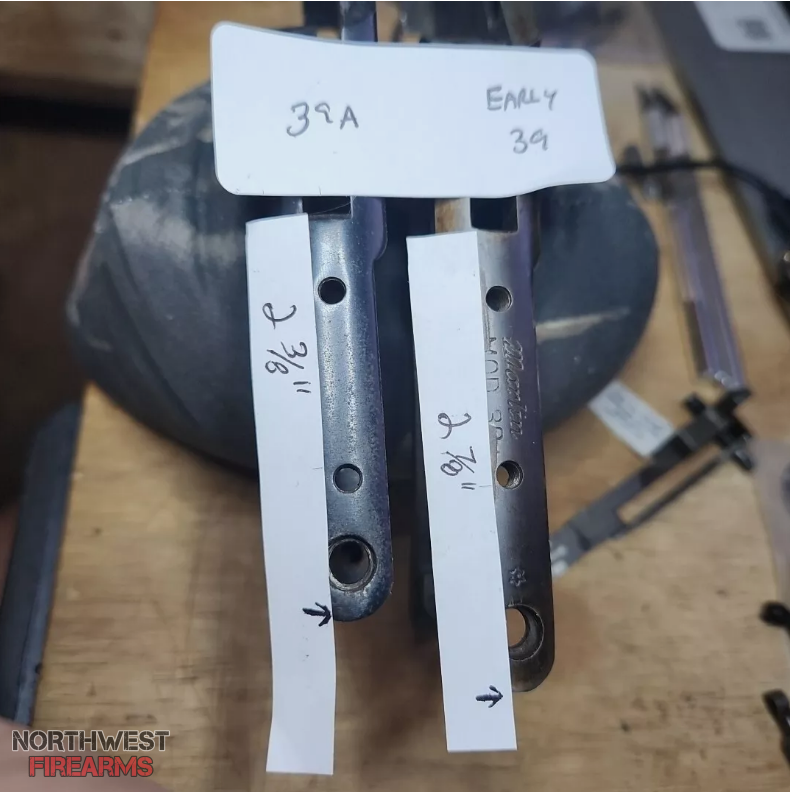

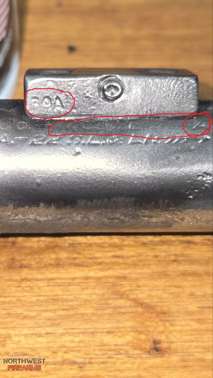

And prior to 1939, there were models that were just 39, not 39a. They were from the early 1920's.
Based on the pics, and the OP's original comments,
It is my understanding we are discussing a 39 A.
Best, Gary
It doesnt match up with a 39A serial nomenclature though, and the tang is the longer tang, the 2 and 7/8 inch. the serial number is clearly no letter in front, and its not worn off or scratched off, I will post a picture later of that.
