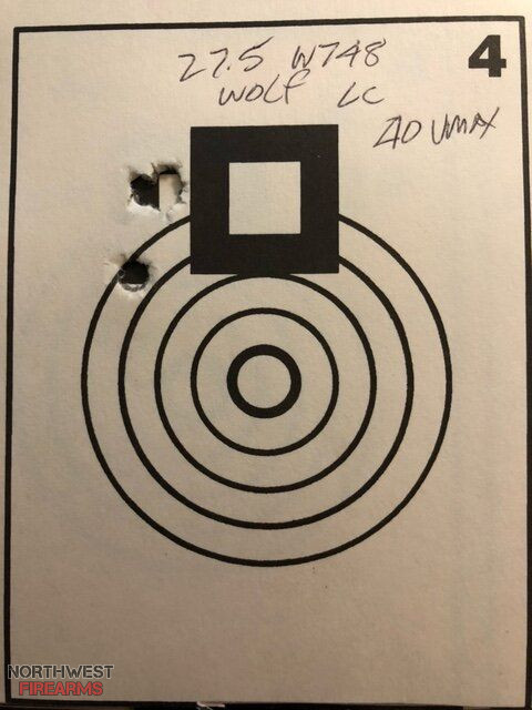

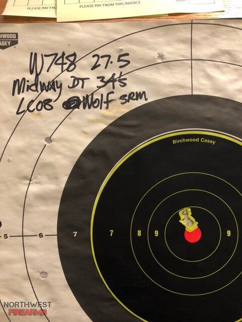

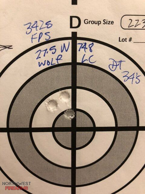

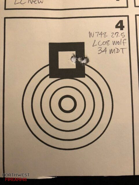

Wrong information here, W748 shoots light bullets great. 5 shots 100 yards with 40 V-Max, 5 shots 100 yards in the rain 34 dogtowns.
View attachment 807682 View attachment 807683 View attachment 807690 View attachment 807694
Nice groups, but I wouldn't go so far as to say information provided was wrong. There is a reason why Lyman and Hornady don't list W-748 for 40 gr projectiles. You give up 200 FPS or more to better suited propellants per the Nosler manual, which, to be fair, did list W-748 as their most accurate powder tested for their 40 gr bullet. Most of us prefer higher velocity when it comes to Varmint bullets, especially when the real lightweights lose their velocity so quickly. For a new handloader, W-748 might be a good choice. I am not sure you could get enough of it into a case with a 40 gr bullet to risk unsafe pressures.
Unless you have personal knowledge Quoting book loads isn't the same. I agree with you Nosler is a great reference. You are also right 28 grains of Tac gives me 3850+ FPS with 34's but 2230/Exterm burns cleaner.
