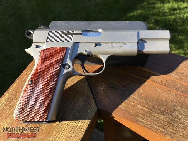

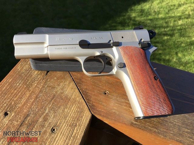

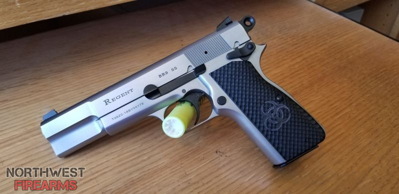

These came out recently and Brownells had them for $510 OTD with a $50 coupon and free shipping.
Being some what of a Hi Power freak i could not resist. I picked it op on Monday and had not had any free time to do more that take it out of the box and look it over.
Finally got to spend some time with the BR9 today, Out of the box the trigger pull on mine was in the 8+ lbs range and gritty. I did the standard mag safety removal and that was a huge improvement and took me down to just under 6 lbs and no more grit. I also did a light polish on the sear and hammer surfaces with some 800 grit and installed a Browning ambi safety. The safety dropped in and worked great, This was a pull from a another gun that had about 1000 rounds on it.
I am very pleased with it in its current state, probably need to upgrade the trigger spring one day as it could have a little better trigger reset but for what will be a range gun it is very solid.
Found a set of Larry Davidson Bio Hazard grips in my stash and I think it put the icing on the cake as they say.
Now its time to schedule a range trip.
