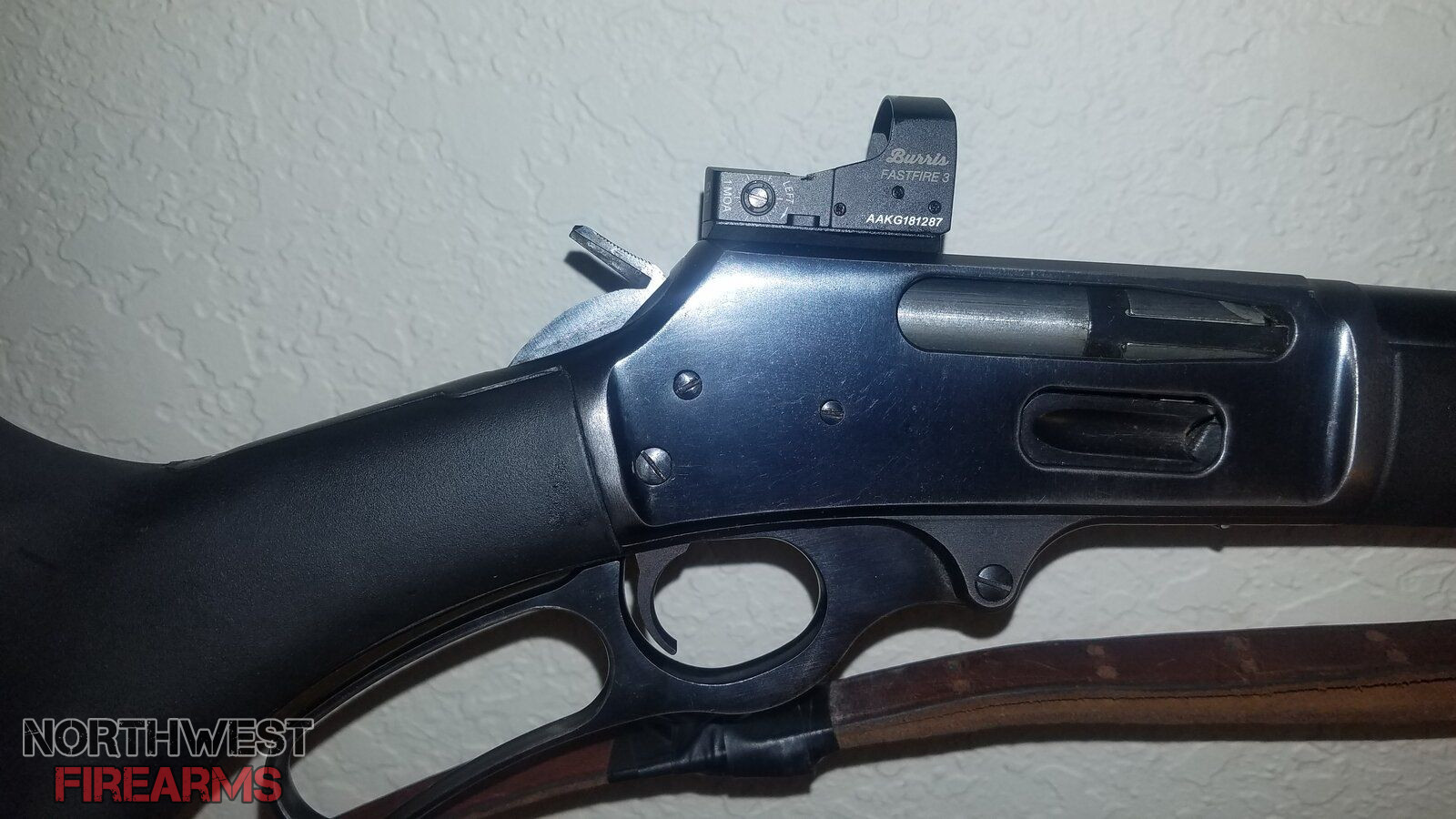

I put a burris FF3 on my marlin 30-30. What a slick setup that was! Sadly, I stole the red dot for another project before I got a chance to hunt with it, but, I will get around to purchasing another one soon enough. I highly recommend It!
