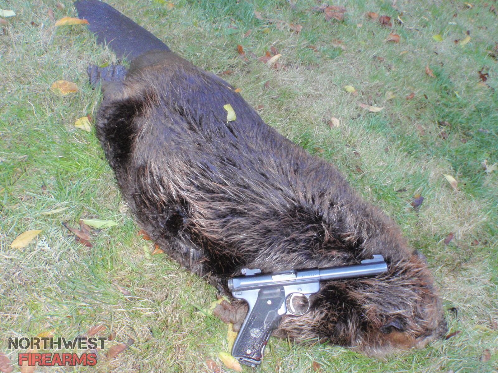

I'm firmly in the camp on the MKII. Also with those recommending a trigger and little else to your "curio".
A Volquartsen trigger went into this one. Crimson Trace grips make for the best trapline gun ever invented.
This gun beat every decent target .22 pistol in my stable for accuracy in an unscientific comparison using my favored hunting ammo.
