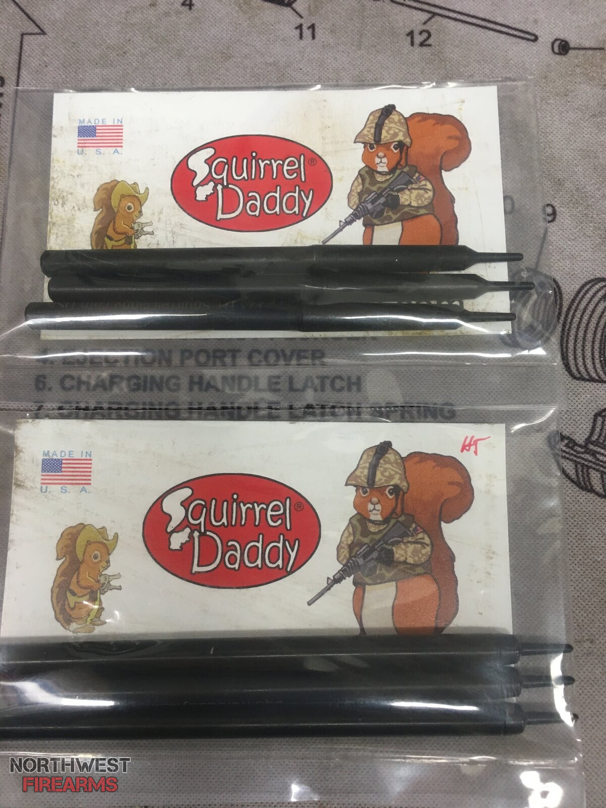

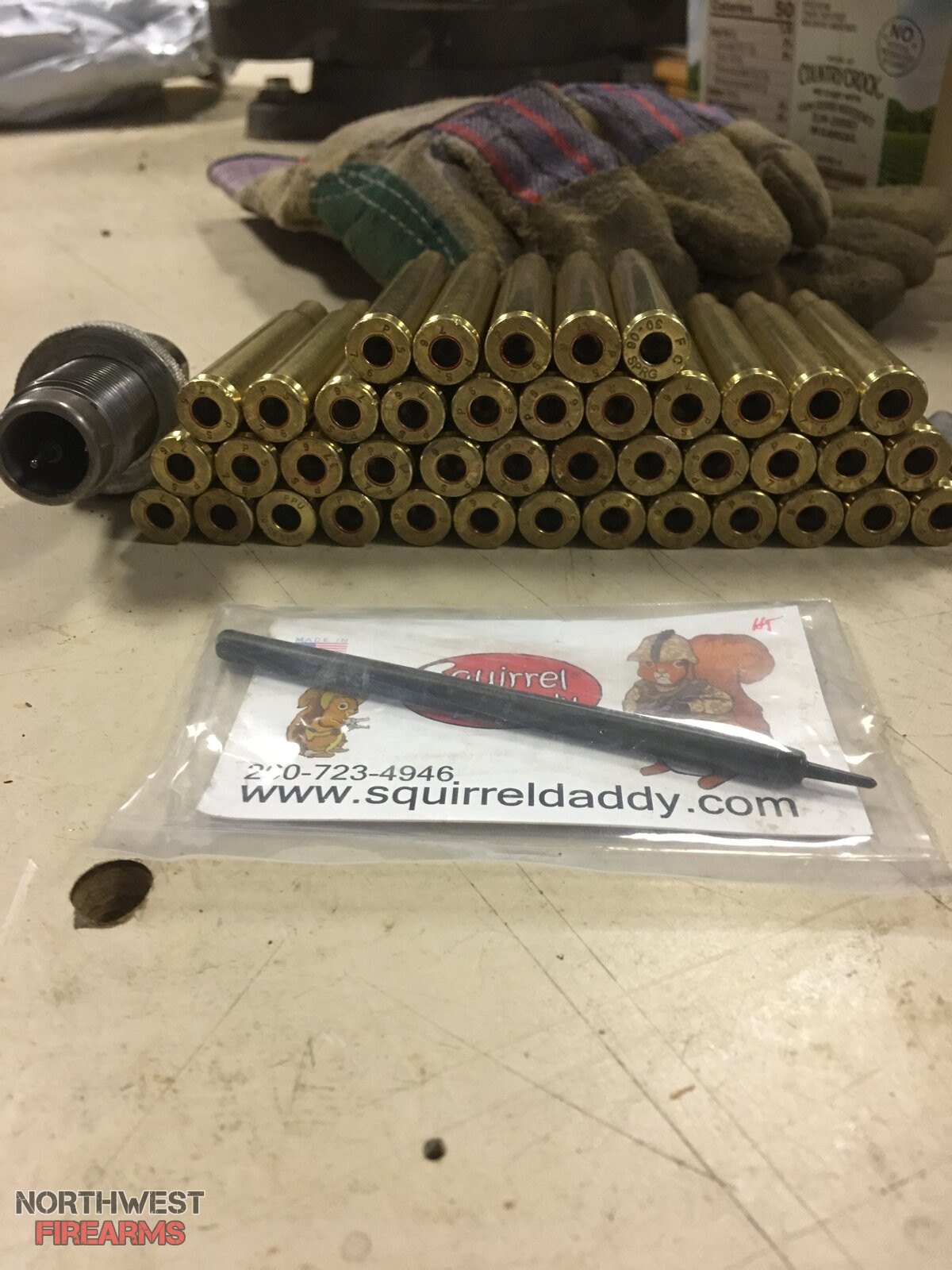

All it takes is one of those bassturds to muck up a prepping sessionand this is why I ordered replacement decapping pins through squirrel daddy a week ago. I received them today and promptly tested on some military 30-06 surplus crimped brass, they worked flawlessly!
I also ordered three of the 223/5.56 pins for my resizing die just in case those hard to deprime cases sneak in.
View attachment 1341402 View attachment 1341403

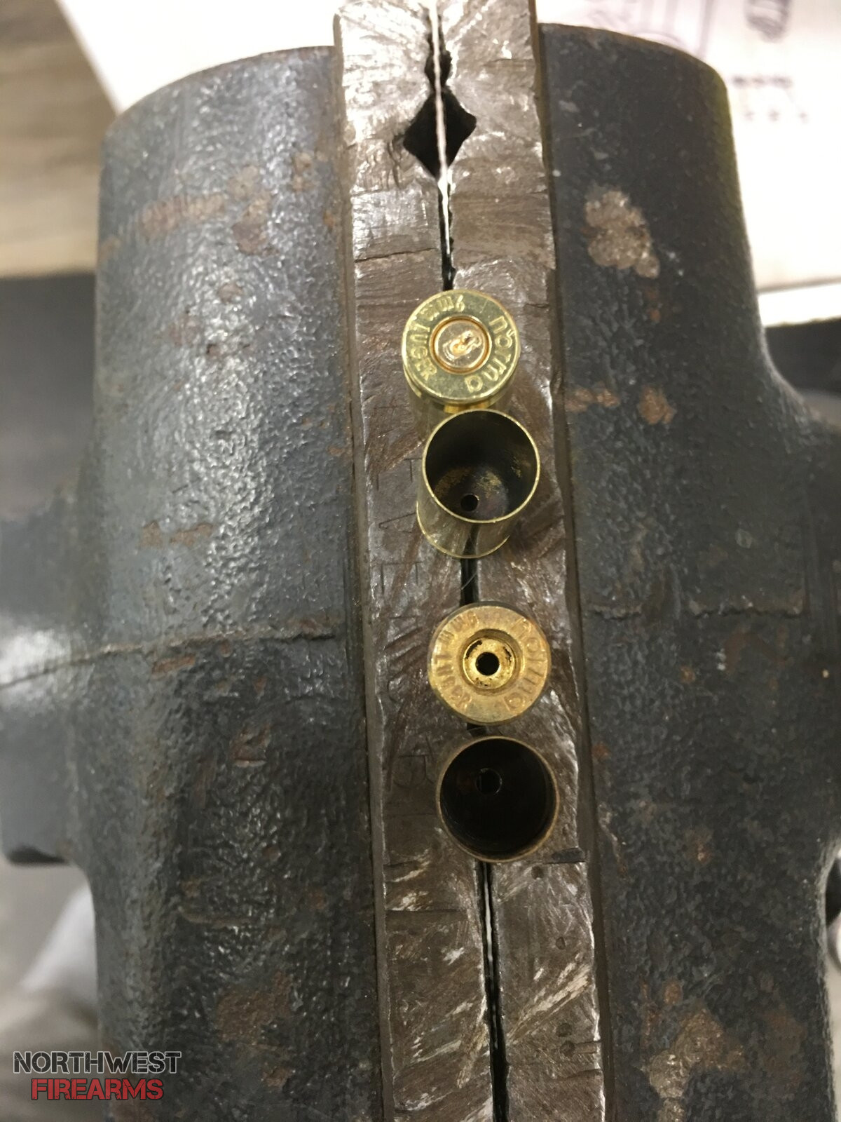

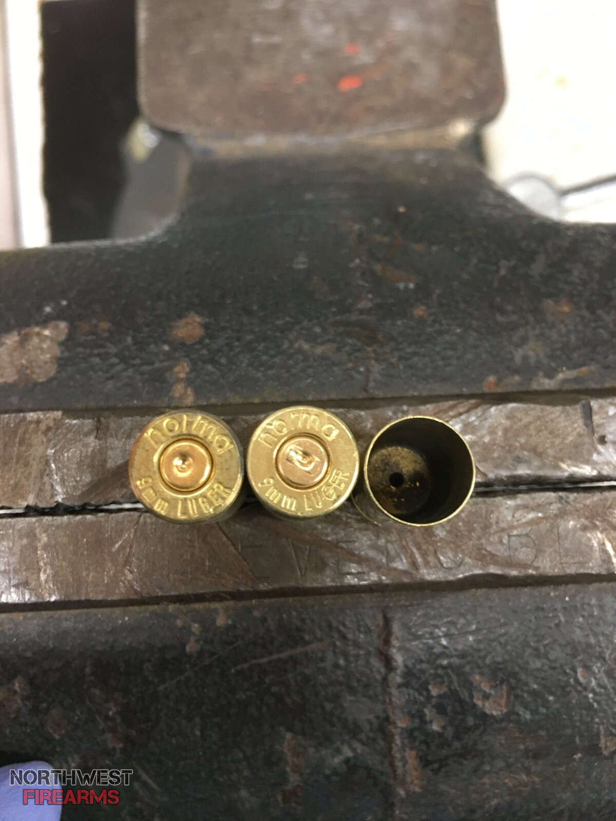

I was processing 9mm yesterday for my wife. Found about 2 dozen Norma 9mm with small flash holes. Found equally as many with normal flash holes as well. I am surprised just how tough the Dillon Die depriming pin is! Going to have to tell her to quit picking up other peoples brass at the range when she's done shooting! :D
I found some pics that I had taken about the same problem. What I've surmised from this is that the head stamp will tell you which cases have the small flash holes.
B109D1BB-E5A9-417A-A21C-DAC444A53B37.jpeg 951D49AE-EA0D-4EF2-AEAF-422F99989EC6.jpeg
