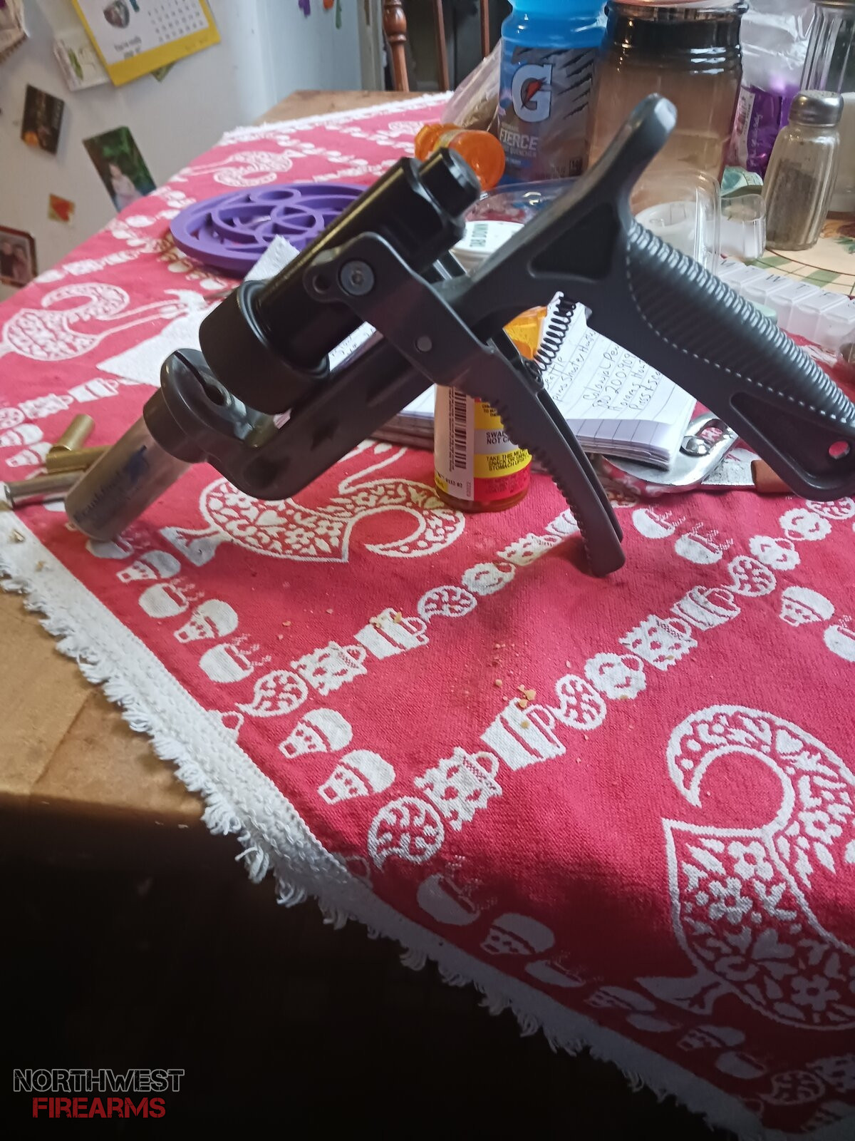

A piece of Norma 9mm brass snuck in my brass yesterday and killed my FA hand deprimer.
I was processing 9mm yesterday for my wife. Found about 2 dozen Norma 9mm with small flash holes. Found equally as many with normal flash holes as well. I am surprised just how tough the Dillon Die depriming pin is! Going to have to tell her to quit picking up other peoples brass at the range when she's done shooting! :D
I run into those 1K 5.56 cases from time to time too. They really suck if you try to size/decap them without realizing it.
I have a Hornady Flash Hole Deburr tool that I picked up used at a gun show some years ago. I found that all I had to do was adjust it for 5.56 brass, then run it up in the case to drill the flash hole from the inside before decapping, super quick and easy, just takes a couple seconds per case. After that it's just regular brass.

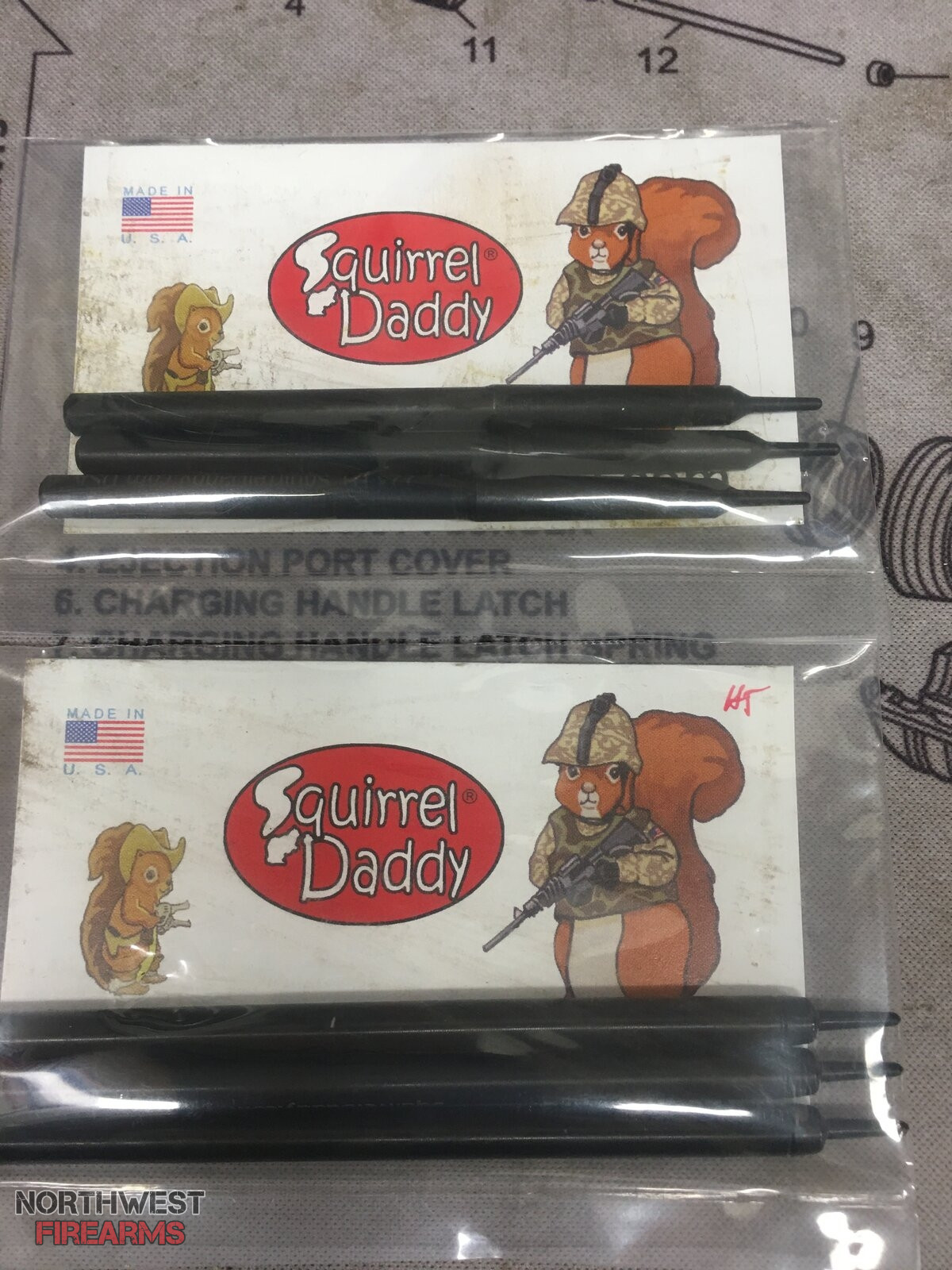

All it takes is one of those bassturds to muck up a prepping sessionand this is why I ordered replacement decapping pins through squirrel daddy a week ago. I received them today and promptly tested on some military 30-06 surplus crimped brass, they worked flawlessly!
I also ordered three of the 223/5.56 pins for my resizing die just in case those hard to deprime cases sneak in.
FADF14C5-2FB6-4235-990B-C81ABB0FC9EB.jpeg 35A5037E-49F5-4DF6-B1B8-832927EFD88A.jpeg
Another attribute for the squirrel daddy decapping pins are they are not rounded on the tip and the same size all the way to the body.
The squirrel daddy pins are tapered and hardened so they will power through that little hole and widen in all with one swing of the handle. :s0062:
