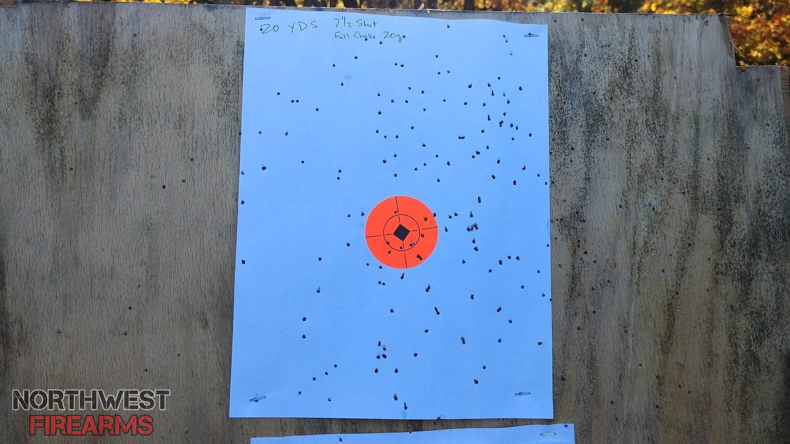

Patterned my 20g with 7 1/2 shot, 2 3/4 inch. Looks like 5 yards is too close, 10 is good. Do you all think the kill power is still there at 20? This is a single shot, so a follow up shot would take a few seconds, and I don't want to have to fire up the brush cutter to go in after one that doesn't die fast enough.
5 yards
10 yards
20 yards. Some of the pattern is off the paper. Standard 8.5x11 sheet.
