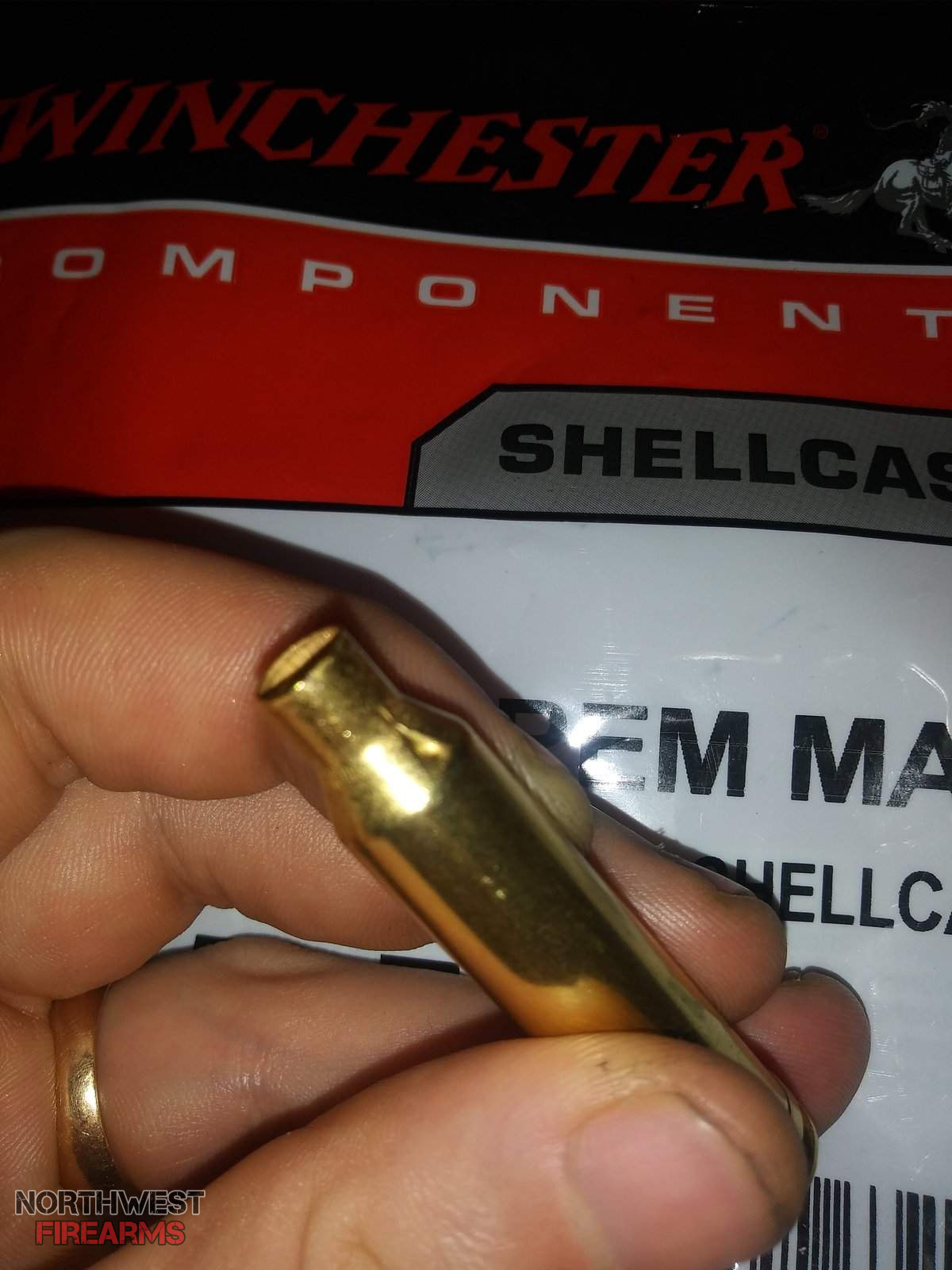

Just curious to see if anybody else has had these issues besides me... I bought a brand new bag of Winchester 7mm Rem Mag brass to do some reloading and development since I got a new rifle and it is time to see what it wants to diet on. I was going through and inspecting my brass as I was throwing primers in it and I was a little shocked and rather annoyed with some of the brass that I found. Now maybe this is a shame on me for buying Winchester brass but irregardless, Winchester's QC (Quality Control) should have caught this I would think...
In this first photo You can see there is a triangular dent into the case shoulder that extends the entire shoulder. The upper section is completely folded/creased. There is a sharp angle protruding on the inside of the case. In my mind this case is garbage due to the fact that sharp creases like that are a stress riser and that will be the failure point. This is exacerbated by the fact that this is a magnum cartridge.
My next complaint is the case mouths themselves. I have found a handful of cases that have out of round case mouths. The case mouth on the left is fairly round and used as a reference. The case mouth on the right has some sharper corners (especially the part more towards the bottom of the picture. (I apologize as it was hard to get my camera to focus on the case mouth.) I don't think that any of these cases are unservicable due to the case mouth being out of round but it definitely means it will have to be run through the dies. Once again, I would think that Winchester's QC should have caught this.
Perhaps this is me being anal, perhaps I am justified in my concern (Especially the dent with the crease). Just thought I would throw this out to you guys to see what you think. It is safe to say I will be emailing Winchester and providing them with the photographs as well. I will be curious to see how they respond.

Okay, the fold or pucker at the shoulder of the case, that is a factory defect. The brass isn't formed right and the added stress that the fold creates will probably cause it to crack prematurely at the mouth or neck. Sometimes you'll see little dings or dents (like oil dents, for example) that get in the shoulder. These are no problem and will fire form out. But that fold will never fire form out. I used to see this occasionally in rifle brass made in eastern Europe. Most newer WW brass is now made in a newer plant in Mississippi. Previously, most of it was made in East Alton, IL. I liked the older stuff better.
I wouldn't load a case with a fold in it like that. I'd throw it in the scrap brass box. Would I complain to the factory about one or two cases like that? Probably not worth the trouble. If I contacted them and they asked me to return the cases, definitely not.
The bent "out of round" case mouths aren't a big problem. You can use the expander button in your sizing die to round them out, just put the expander button slightly into the case mouth, don't push it all the way through. Or you could use a tapered punch (like a center punch to gently round them out by hand.
Yes, some of the bent case mouths are attributable to handling during shipping. You should see some .38-40's that I just got from Midway. Yes, they were in a small box of 100 but the dopes in the shipping department shipped them in a plastic bag.
Of more concern to me would be the ragged edge on the case mouth. Or so it appears in the pictures. Even if the cases aren't over length, I'd be interested in trimming them enough to cut the rough edge off. I've seen that on WW brass before. And in my experience, if any one brand of brass is going to be over-length from the factory, it's gonna be WW. So best to check it for that as well.

Out of round case mouth is normal. You will want to run these through a sizer die or at least over the expander ball - that way they will be closer to how they will be in subsequent firings. In other words you have controlled the neck right from the start not the manufacturer.

Winchester brass is not "ready to load" out of the package. They should all be sized, trimmed, chamfered and deburred prior to their first loading for best results. Not to say you can't just load them right out of the package, but that is not what is intended. The first picture is a case forming defect that is fairly common, throw that one away. The out of round neck and various dents and dings come from the final tumbling process before packaging. Nothing to worry about there, just need to size them and prepare them like a once fired case.
