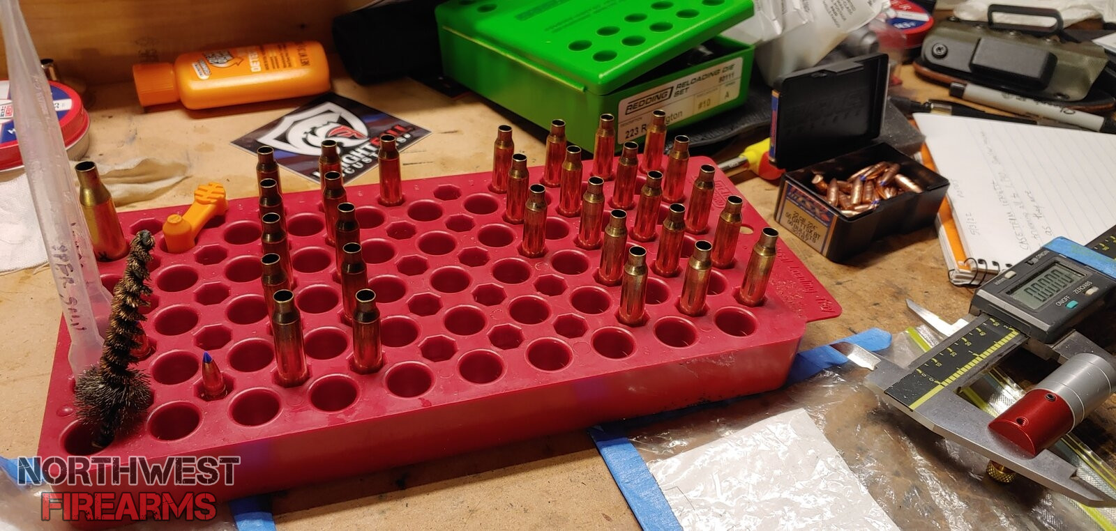

wow, I just swabbed inside one of mine drying and it really cleaned it up nicely. Thanks for this tip...With swabbing this is what I get:

BTW the qtip swab trick works in the primer pocket hole too. Apparently inside surfaces dont get enough sonic waves to break them free on their own but they do wipe off pretty good.

The inside surfaces all cleaned up nicely with a few qtip swabs. Good tip...
