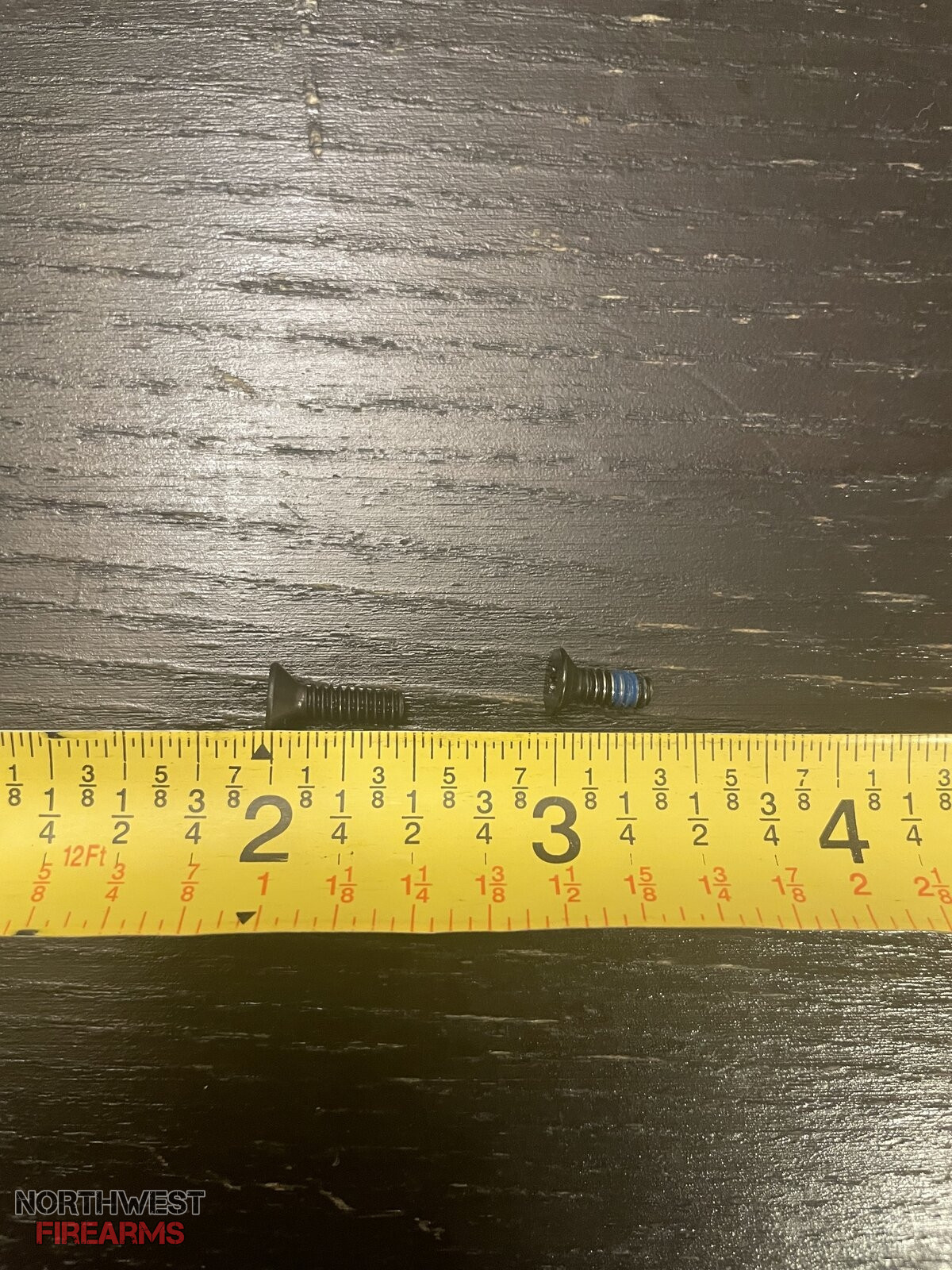

By that I mean then length of the screws.
One of the left is the new ones, the one on the right is the one cause the fly off.

What size is the correct threads? What is the correct torque needed?
If your rounding screws your doing something wrong. This isnt a 'hand tightening' project, you need a small torque wrench for pistol red dots.
You need :
1) Correct thread pitch and screw size
2) Correct length
3) Loctite (use blue)
4) Torque screwdriver (know correct torque)
You need to hit all the above items to do this right

Got all sort it out. turns out I bought the imperial unit size screw which is 0.5mm smaller than the HK's metric screw.
Thank you all for helping the noob.
