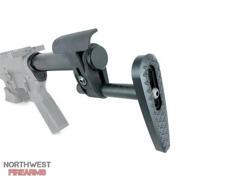

You can either install taller scope rings, riser blocks, and/or move your optic further forward and extend the length of pull on the stock and "snake" your neck forward thereby lowering your line of sight to the optic.... or find some kind of off-set gizmo you can put on the end of the buttstock that will raise the entire thing up to your noggin where you want it.
Something like this thing...
Here's the link:

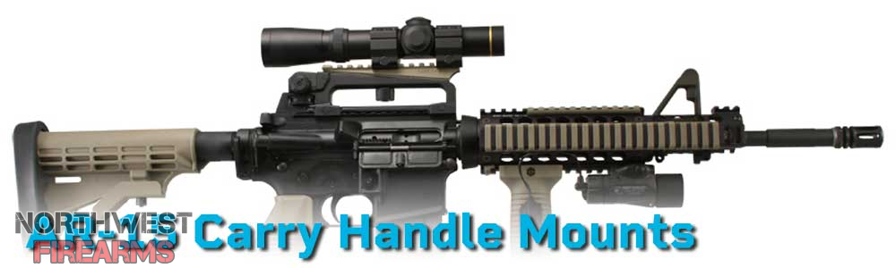

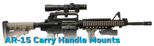

Ha! We seem to have found the guy they designed those A2 carry handle mounts for;
Most of us need to really stretch to use these things, but they may be just the thing for you. You could probably even pick them up used for cheap, since most people who try them out wind up hating them. The only problem is your height-over-bore will be nuts, which will complicate your zero, but that is nothing a good ballistic calculator cannot sort out for you.

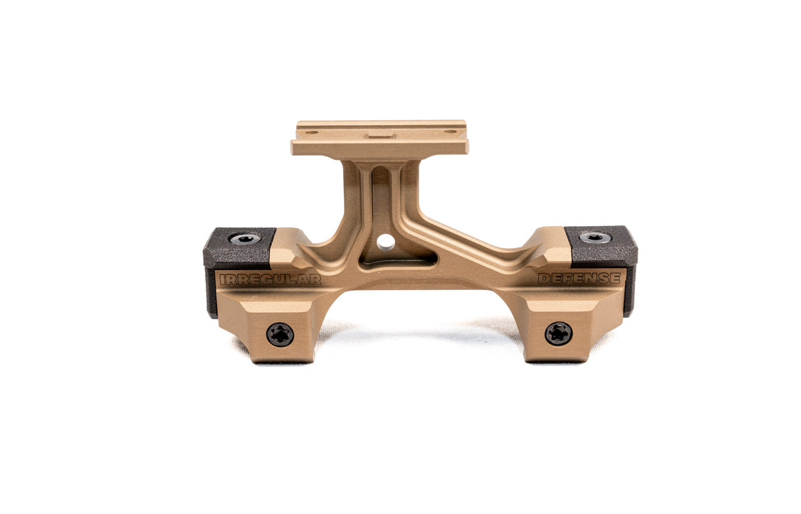

2.91" seemed outrageous when I was optics shopping but now that reality has cropped up I'm thinking it might be the ticket.
I tried it. I sold it.
If i did it again id go with the Irregular Defense version as Slade is the one who came up with the design and GBRS just knocked it off after they kicked him out of the company.
Loyalty over integrity is their motto and it shows.

That link has flat-top AR carry handles. I have one and it works great for what it does. Solid mount, no wiggle and it is a repeatable mount in case you want to take it off. My only problem with it is it puts the optic ~4 inches over the bore with standard rings, and that is a bit much for me. Now I just keep it for retro style builds and forgo the pic rail adapter. I still find carry handle irons a bit on the tall side, but they are nowhere near as bad as mounting an optic up there.
Hold overs get tricky that's for sure.
