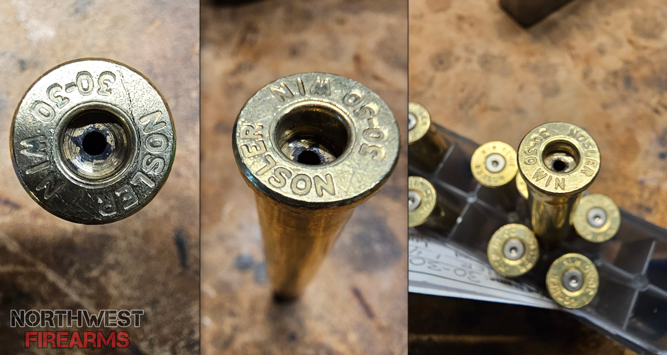

Once again, Nosler brass quality lets me down. I know its "just a 30-30" but this isnt the only caliber Ive had issues with Nosler brass. A rough measurement is about .020" offset was just enough to pick up by eye, very visible when rotated in a V groove.
Would you keep using this case?
Me neither, Went to start prepping these and noticed one with a primer strike appearing way off center. Nosler brass has been nothing but a thorn in my side since I started reloading, I always assumed they were a higher end company so I bought Nosler brass for several cartridges I have at the beginning and gave up on all the rest. Decided that since this was "just a 30-30" Id go ahead and use these since Im frugal but not even "just a 30-30" can escape Noslers mark.
Yeah. I would. But I might choose another manufacturer for my brass next time.

I marked this one and will load it the same and see if it shoots noticeably different velocity or POI. I'll probably spin them all in a V groove to look for the pocket position being off center. Ive had nothing but issues with 3 different calibers of Nosler brass now, I gave up on the other two but this is "just a 30-30"... bugs me now though.

I know its "just a 30-30" but a hundred bucks for a bag of 100 and not have centered pockets is a joke. All I wanted was a simple supply to last and was willing to pay for it and have been burned every time.
In my head I'm having trouble coming up with a scenario that primer hole position offset would have much effect (as long as it ignites the powder), but I'm not a scientist. Like you mentioned, for the price I would have expected Nosler brass to be better than Starline or Hornady, not inferior. I have a friend that was an engineer at Nosler. If he still worked there, I'd definitely have some questions for him. Kind of lost touch with him and he works for a small aircraft company now, or at least did the last time I heard from him.
Flash hole consistency plays a noticeable difference in precision ammo, the flash needs to run to the powder unobstructed and on center to burn evenly. I would think an offset pocket would be even worse.
Whats interesting is I had a different point of impact with this production "lot" of handloads than last time, same recipe. This time the group was inconsistent in both group size and POI. I don't know if it was my handload or just the old lever gun with a pitted shot out barrel but it held 1moa with the same handload 2 weekends ago. I have struggled with this and have been thinking its just the old rifle but this makes me wonder if I should try different brass.
I've used several cases of other brands that were offset like that and they are shot just fine. As for brass, I'd switch to a different brand of you're having continuous problems with their brass.
Being off center won't change the ignition one darn bit. The only place that might cause a problem is punching out the used primer. In over 45 years of reloading I've encountered off center flash holes on the highest quality brass before. Stuff happens. It reloaded and shot just fine. And again it won't change the ignition of the powder one darn bit.
It makes me think about pressing the primers in. Still may not make one bit of difference in the final outcome. But after hand priming several hundred 9mm in the last week or so, some of those primer pockets take a LOT of pressure to get primers seated.

Primer pocket or flash hole? Hard to tell by the pics.
