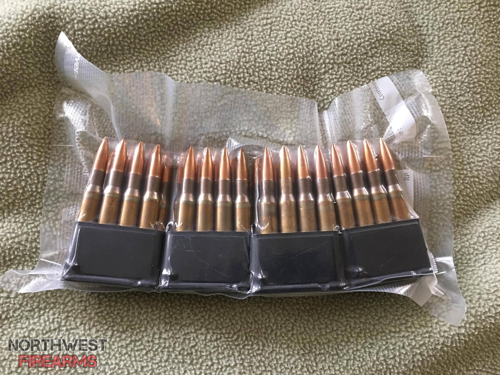

Vacuum seal that ish and store it wherever you want.

I use a food sealer on my range ammo. It sucks out all the air and sealed them air and water tight. Usually 100 rounds to a pack. Then I take them to the range in a metal ammo can. The loose rounds go into a plastic ammo can with a desiccant and are good for many years.

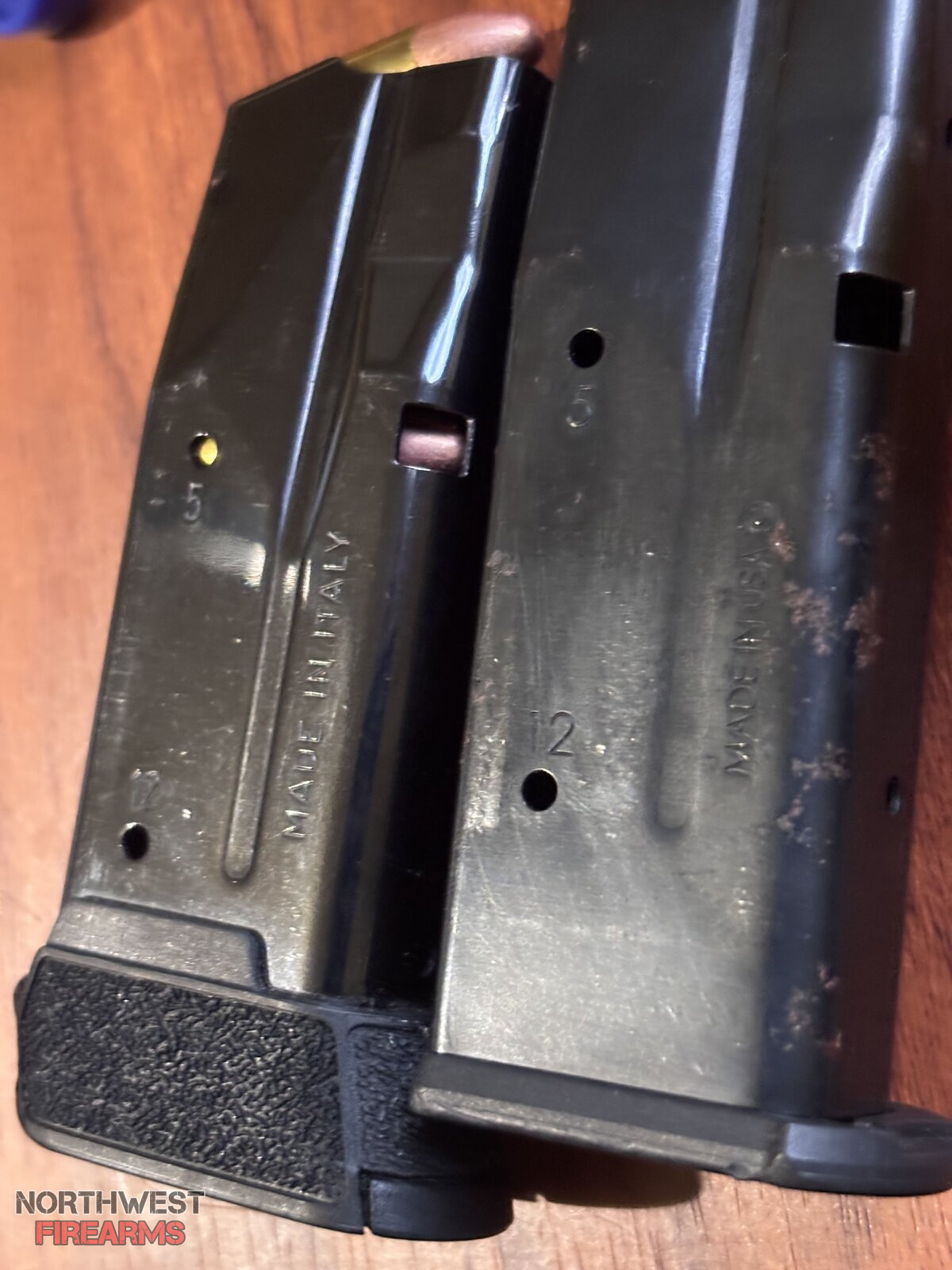

Humidity in cold areas it terrible in my area. Left a shotgun in inheated garage and became totally rusted. Left the magazine on right in garage for 2 days and that's the rust that formed (see pic below). We have room with lots of glass unheated and humidifier has to run 24/7 all winter to prevent serious mold. Avoid storing in unheated garage at all costs is my advice. Heated basement totally fine.
