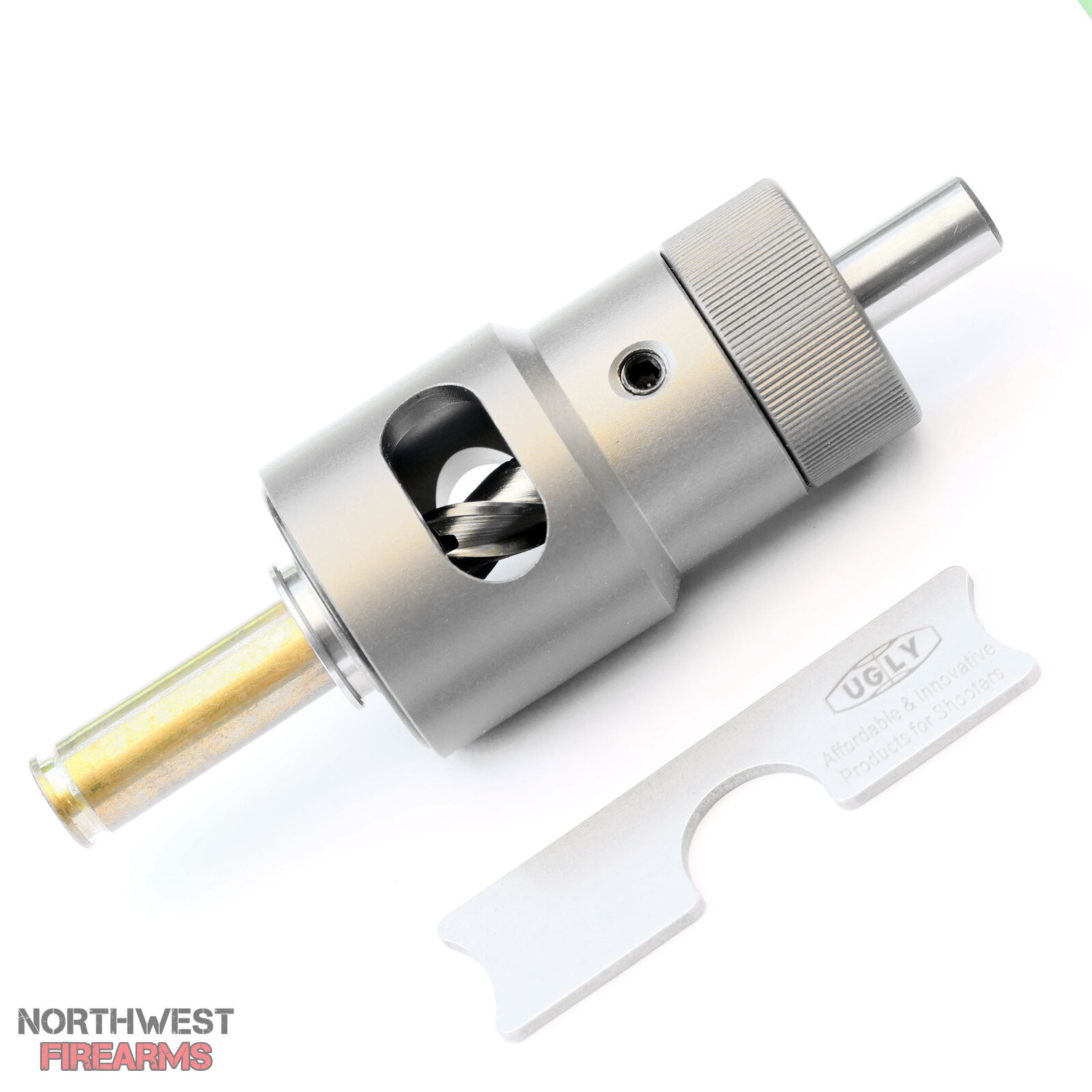

Just came across this "new" case trimmer while looking to replace the Lee Trimmer for my .222 Rem. It's kinda nifty in the way you "micro" adjust the cutting length in that you loosen either the top ring or the body, put a feeler gauge in between the thickness you want to adjust, then tighten the set screws back up. It's $56 on Amazon and I'll report back with how it works.

Trimmer arrived today and it was a snap to setup for my .222 Rem. Adjusted to a finished piece of brass, chucked it up and trimmed away. End result was right on the money. I just ordered three more to retire the Lee Trimmers I have for the rest of my bottle neck cartridges. I will set those up long and use a feeler gauge to test the "micro adjust" portion of the setup which I am sure will be spot on.
