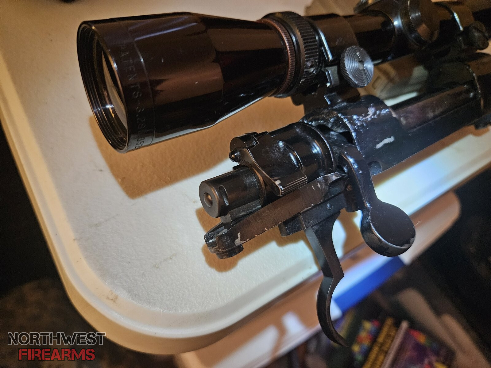

Im trying to iD this rifle my great uncle brought back from Europe in WW2 and sportorized not many markings to work with says it used to be a sniper variant its in 8mm I can take more after work thanks yall

There may be someone here good enough to ID the rifle by just the trigger, but getting a couple more pictures would certainly help. Some of the bolt/receiver? The front/rear sight?

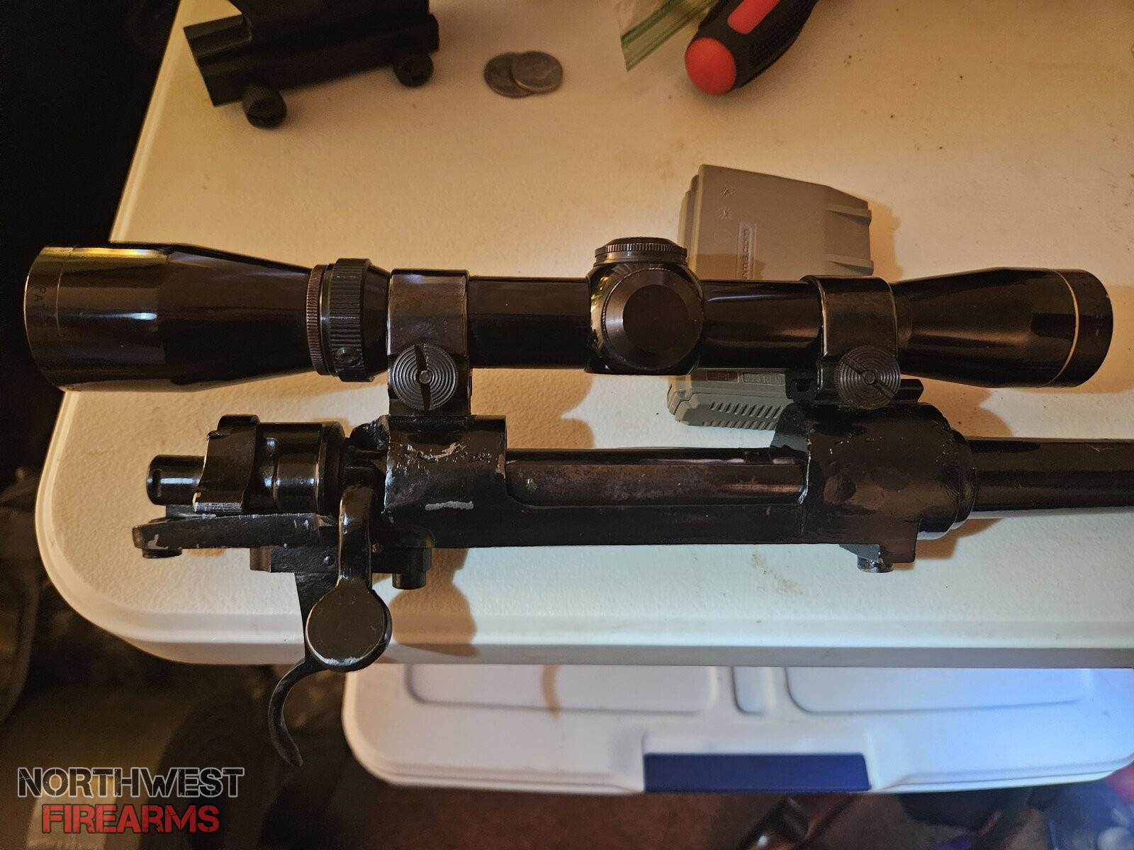

If it was issued as a Sniper rifle you will find the holes where an optic was attached. any gun can be used to snipe , but those issued to a sniper will have been altered for that role. do a little research into what optics and mounts were common, and you will find the corresponding holes. DR

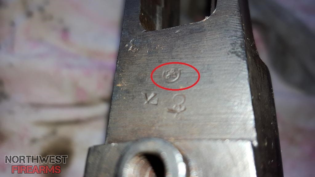

It is also on your trigger. I googled "Spanish Mauser M43 proof marks" and hit images and started scrolling. Both of those came from forums.
I'd like to thank yall very much for the information im pretty sentimental about the rifle ,gonna post some of the other markings later on the pictures I have currently are just too blurry
This is not always the case. Especially if it has been sporterized.
I have handled hundreds of mausers throughout the decades. Ive lost track of how many "my grandfather brought it back" rifles and lugars, that were parts guns assembled post war. In that group, the number of "sniper" rifles was high. At least once or twice a year, we would hear "it was a sniper rifle, see here, the holes for a scope."....that happen to be drilled for generic weaver bases and rings lol
There is only a few ways to correctly ID them, serial numbers and records being the most accurate. Some slipped through the cracks for sure. Many where modified in the field with no or very little, records to authentic. Post war, parts were cheap and easy to find and that opened the door to thousands of parts built fake snipers.
Anyway, the proof marks, and ring will tell its story.

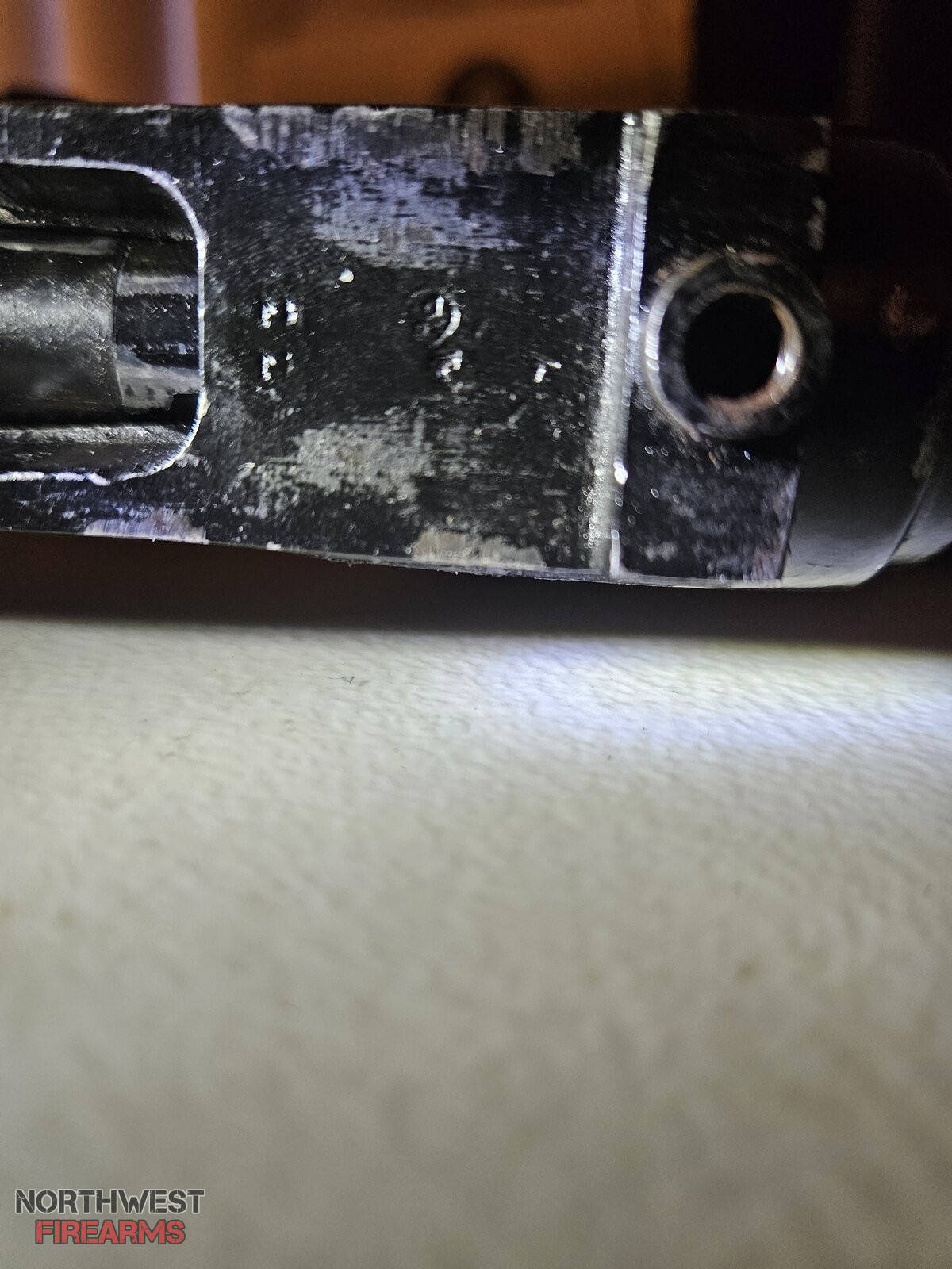

What's the measurement of the action screw holes?
Looks like it was scrubbed which was coming back then. The numbers off the Floorplate and magbox are gone. Some didn't have them but hard to tell from the pics.

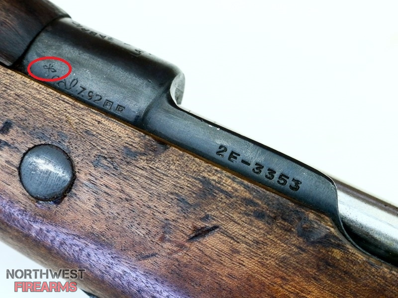

Here is one that was sporterized but kept thr markings.
Drilled for weaver bases .... 😉

Okay biggest is 1 5/8ths , medium is about 7 8ths
Hey yall just like to say thanks for the help 99 percent is pointing to spanish m43 and arrowshooter in particular for finding the markings God bless yall
