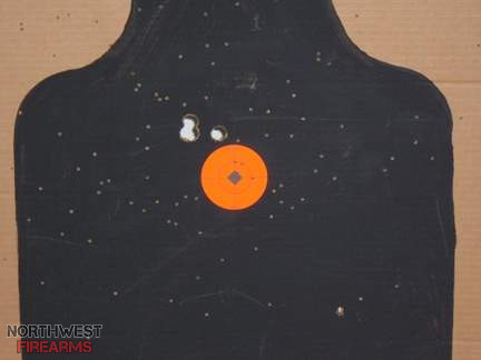

29° F But I got a chance to shoot today. This was 4 rounds of Brenneke Slugs followed by 1 Round of #4 Shot, off of a rest at 35 yards.....Just wait until my wife sees the couch and the wall..:rolleyes::p Found later the front sight was cocked to the left.
