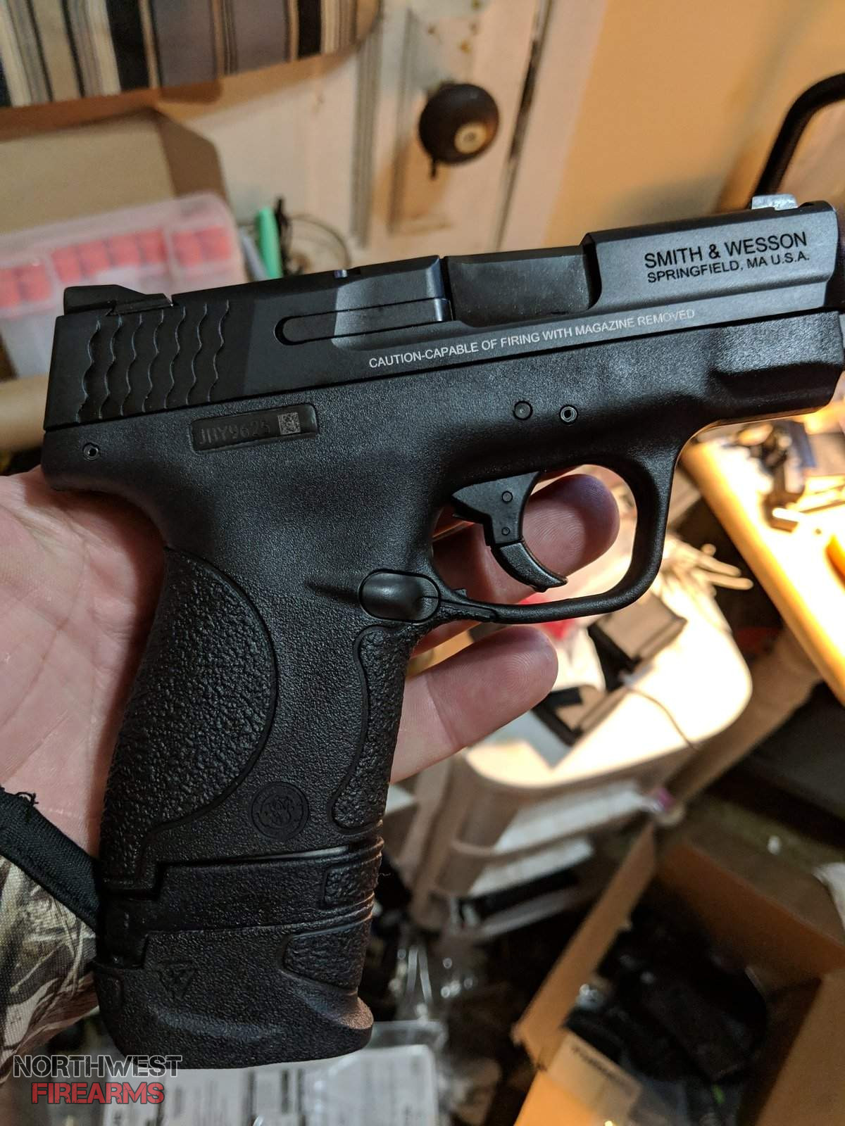

Just got a shield today and that's why I got it for the hot summer days that I can't wair a heavy shirt to cover my hip.
I just also ordered a inside the wast holster for it . even though I don't think I will like it .
But I will try anything .
To make sure I can carry conciled every day of the year. And I have not FIRED this gun yet but it feels good .
